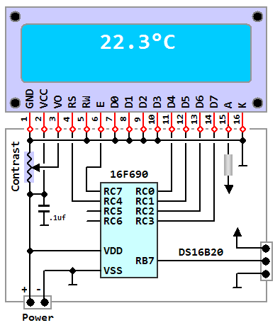

Here's an assembly language example for a 16F690. I hope it helps.
Regards, Mike
  • AAC 690+LCD.ASM.TXT
thanks to all the users above for providing the links.... but i don't have pic16f690 i just need the temp to be displayed on 16x2 lcd i searched in Google i got some circuits but its all using seven segment display...or its using atmel and to tell you guys i am just a electronic hobbyist....
