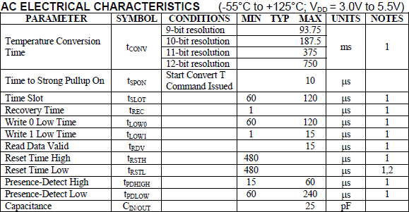

Ok lets concenrate on the Reset routine.
Looking at the timing diagram and timing table...
So given the interrupt is 43uS long, theroretically, can't the interrupt be enabled for the whole thing? Providing the interrupt doesnt change the state of the DQ line??

.... So given the interrupt is 43uS long, theoretically, can't the interrupt be enabled for the whole thing? Providing the interrupt doesnt change the state of the DQ line??
Yes, I think that should work... I did not disable interrupts in the OwReset routine in my very old DS18B20 + 7-Segment project from years ago...

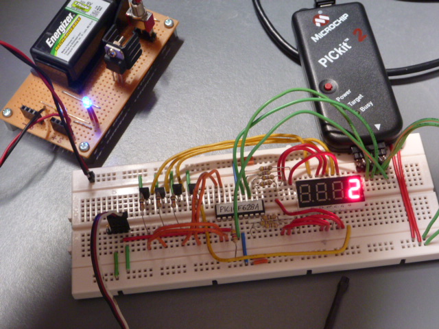

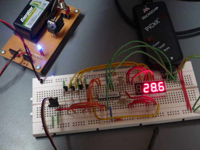

Pictures tell more than words....
Works fine for a few mintues...
p1000477-jpg.47207
Then...
p1000478-jpg.47208
And its not always the right most digit.. Its any one of the 4. It like the interrupt stops getting triggered.
That or the program goes into a undesired loop.
