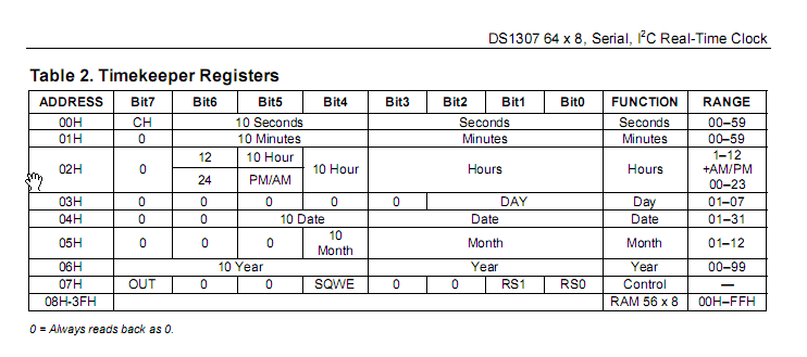

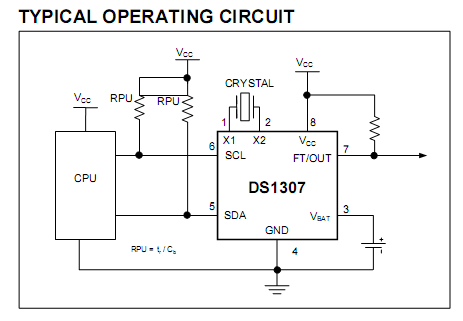

Look at these images.
It sounds like the DS1307 is being stopped at power down for some reason.

I use a 3V lithium battery, works OK.

Thanks to all my problem is resolved
dear ericgibbs u and CCD
I scope the crystal and i see when i dis connect the Vcc the sin wave of crystal goto dead line in 2-3 sec ! i check the battery and find in my circuit capacitor connected between gnd and battry ! i remove it and anything is now okay !
