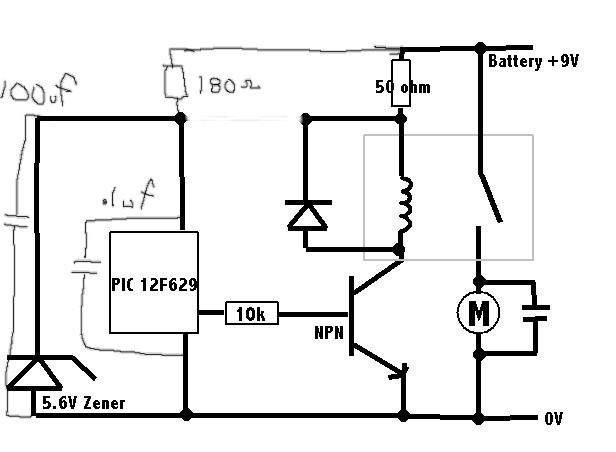

I have this circuit
The problem is as soon as it powers the load (the motor) it starts acting crazy.
I think the current drawn by the motor causes insufficcient power to keep the PIC on, so it turns off and starts its code from the begginning.
This is producing some very strange and annoying problems.
Without the load everything acts fine.
Does anyone have any suggestions for solving this problem?

If you want to use the circuit you have then add the 2 caps and resistor that I have added to the schematic. I would only use this circuit for testing as it draws a lot of unneeded current from the battery even in standby. If it something you are going to use a lot then redesign with a mosfet.

There is no reason to to be isolating the relay- the NPN transistor and the relay coil already provide two different isolations themselves.
Your problem is the shunt regulator you've built. It will lose regulation when current exceeds 68 mA, which is likely since you're powering a relay coil.
The capacitor will do nothing at all to prevent the shutdown in the long term. It will provide a few milliseconds of power for the relay coil and then the voltage will drop enough to kill the PIC.
The shunt reg draws a lot of power from your supply for no reason, too. It draws 68 mA, the max supply capability, all the time whether the circuit needs it or not. Just add a common 3-terminal regulator. It will draw maybe 1mA above what the circuit consumes, and can supply up to an amp or so if it's heatsinked. For the circuit you show, it probably doesn't need a heatsink.
You can also use a NPN transistor or preferrably an N-channel MOSFET to drive the motor directly, exactly the way the relay coil is being driven now. A bit simpler. The transistor needs to be appropriately rated for the motor's current and a flyback diode must be in parallel with the motor. In fact, your circuit already needs a flyback diode across the relay coil.
A small ceramic or tantalum (0.1 uF is fine) on the PIC's power pins, right at the PIC, is always recommended although most applications will work fine without it. It filters the small surges of power with each clock cycle.

The huge design flaw in your circuit is to feed the relay off the (very poorly) stabilised supply to the micro. As soon as the relay turns on it's going to produce a large drop in the supply to the micro, dropped across the 50 ohm resistor.
Adding a capacitor may help a bit, but it's far, far, better not to feed the relay through the same resistor as the micro.
PicChristmas does what I would suggest, provide a proper supply for the PIC, and leave the relay totally seperate - that should cure all your problems, but NEVER try and design a circuit like that again, it's really excruciatingly bad design!.

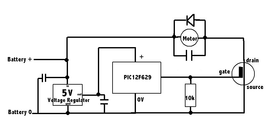

A 5V power supply is more conventional. It will operate more consistently as well, under high current drain the battery voltage may fall and may not be high enough over the regulator's minimum dropout voltage to continue providing 6V.
Most regulators MUST have a small capacitor on its input and another on the output, failure to include these may result in oscillation which may include peak voltages that are physically destructive to the PIC. You did not mention these in your schematic.
There is NO need- none- for a "protection resistor". Connect the pin straight to the gate. You should run a 10k resistor from the gate to gnd to ensure that it stays off in the moments where the PIC is tristated.
Ideally you should add a small ceramic capacitor across the motor's terminals too. This will filter out the motor's brush noise and lower interference to your TV and such. It's unlikely the noise would be large enough to interfere with your all-digital PIC system, but it's still a good idea.

Does this look better?

Yes, that's looking far better - one thing though, you don't show an electrolytic across the supply, you need a decent size one, 220uF should be OK, directly across the supply. It's particularly important for battery powered applications!.
The capacitors on the regulator aren't very critical, 10nF will probably be fine (I usually use small electrolytics, between 1uF and 10uF, whatever is small and comes to hand). They should be placed as close to the regulator as possible
