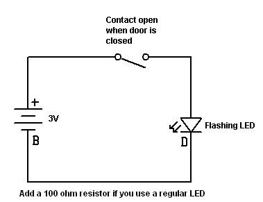

As BlueRoom suggested, you can get both NC (normally closed) and NO (Normally Open) door switches. The most common one, used in alarm systems, is the one where the switch is closed (On) when the door is closed. You want the opposite type. If you are confused by this, buy one that has 3 terminals. That way it will have both NC and NO contacts:
Then just put the flashing LED, switch, and battery (You'll need 3V or more for a flashing LED) in a series loop.
If you're using it it for security, you're better off using a NO reed switch that closes when door is closed, as rodalco suggested, then if a wire is cut from switch it would indicate door open condition.

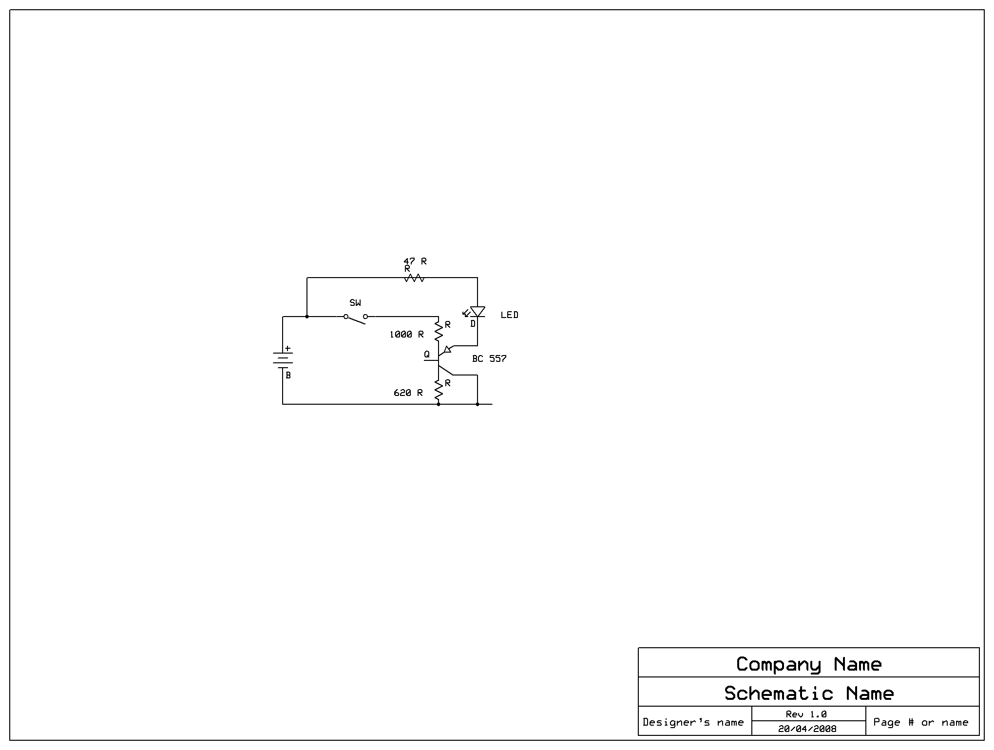

If drawing programmes weren't such a mission on a computer I draw you a schema.
Basically your circuit will be as follows.
1.5 Volts supply.
Positive to reed switch, then to 1000 ohm resistor, then to 620 ohm resistor then to negative. Currentflow about 0.9 mA.
At the point wher you join the 1000 and 620 ohm resistors , drive the base from a PNP transistor.
The PNP transistor can switch the LED ON or OFF.
How it works.
Door closed, switch closed, LED OFF. The PNP transistor has a positive bias at the base and is turned off.
Door open, switch open the positive bias has gone and the 620 ohm resistor pulls the base of the PNP to negative which turns the LED on.
Hope it helps,
Regards, Raymond
I hope this attachement works.
I'm not sure if your 1.5 volt battery voltage is high enough for the LED.
If you go for 3 volts, double the resistor values.
Regards, Raymond
If BigBill uses a flashing LED he doesn't need a resistor. The circuit you posted has a high standby current and will drain the battery unnecessarily. A 1.5V battery will not light a LED. He'll need a 3V supply:
