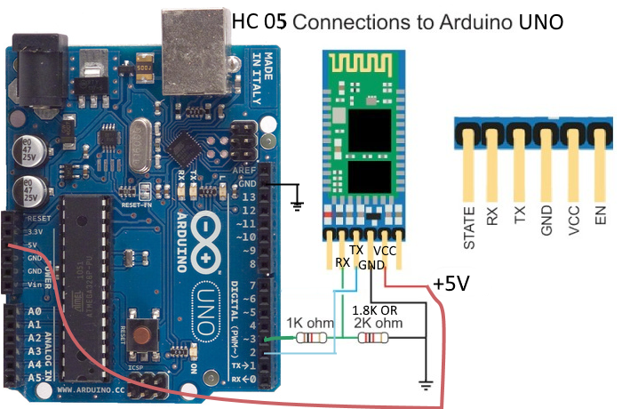

dont know how to use bluetooth module hc-05
This code let's you use the atmega both ways it to show you how it work from there you can go on and do what you want.

#define rxPin 2
#define txPin 3
#define ledPin 7
#include <SoftwareSerial.h>
SoftwareSerial mySerial(rxPin, txPin);

don't change it Use just as is
You type a 1 send it the led comes on you type a 0 send that led goes off if your using a bluetooth terminal
and using the stuff I showed you.
Now your HC-05 maybe set to use 38400 that depends on how you messed with it.
doesent work
That doesn't tell me nothing did you hook it up like i posted in post 26 ???
That code works only for that way
If you hooked it up like that and used the code I posted your HC-05 maybe still set for 38400
You then change this one line
mySerial.begin(9600);
to
mySerial.begin(38400);
If one of those don't work you have sent at commands and changed your HC-05 settings and it will need to be resetup

Try this
SoftwareSerial mySerial(2, 3); // RX, TX
void setup() {
  // Open serial communications and wait for port to open:
  Serial.begin(57600);
void loop() { // run over and over
  if (mySerial.available()) {
    Serial.write(mySerial.read());
  if (Serial.available()) {
    mySerial.write(Serial.read());
It let's you talk from PC to phone both ways
and should work try it out
Serial.write(Serial.read()); is the right way but with this your just talking from the pc to atmega .
My code lets you talk PC to atmega to bluetooth to phone which is what you need to under stand first.
