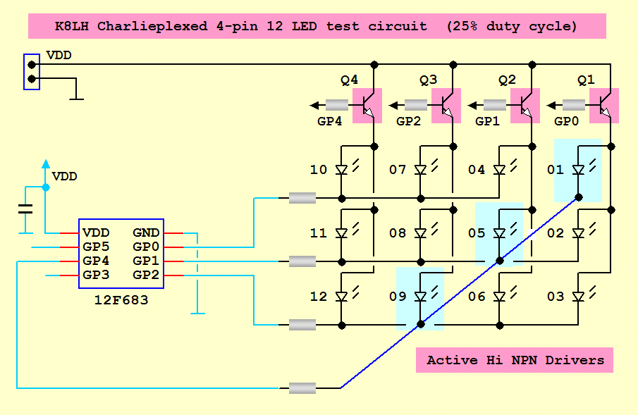

Does this asm code look correct ? PIC12F509
Darkstar64
Here is the code im working with im chaliplexing 12 LED's with 4 outputs from the PIC included is the curcuit diagram for refrence. This is for the letter S it should cycle through each LED with a 100 µs delay between LED's as well as it loops 1000 times in 1 second
Sam

Diagram everything is based off of this
charlie-12-png.21589
You seem to be missing the matrix part of the above display and making things a lot more difficult for yourself than they need be.
If you make GP0 high and GP1, 2 & 4 low then LEDs 1, 2 & 3 will light. This isn't very useful but if we play with the data direction register we can light any combination of these LEDs, if GP1, 2 & 4 are all inputs then no LEDs will light, make one or more of them outputs and the corresponding LED will light. This is how 3 LEDs can be controlled at the same time.
Here's some code which does the multiplexing. With this code each bit in variable LEDs and LEDs2 represents 1 LED. So, you can setup a bit pattern in the variables and call multiplex and the correct LEDs should light. If you change your delay routine to take 250uS then the multiplex subroutine will take 1mS and make for easier timing.
Code, untested.

O haha I get it now but how would I then call each LED in the Multiplex subroutine I see that it is just configureing the LED's then putting numbers to them so that I can just easly call the the number and not the whole bit and write thing. And then what about the loop do I need it or do I just call the numbers somehow and then add a delay of X then set all the bits to inputs but even then I would have to have it cycle though each colum to refresh the display 1000 times a second so ya im still confused haha also on the build im getting so strange errors here is the log don't wrry about the counter and counter 2 I deleted a few things that casued that just haven't fixed it yet

I would like to help you but you refused to answer my question on your other thread about showing the actual physical LED layout. I just don't see how you can form letters or characters on 12 LEDs and so I don't understand what you're trying to do.
Mike
I would have 5 outputs so I could use 16 LED's it would be easyer to make letters out of if that helps I will be using the same multiplex Idea but I need some way to allow me to be able to chose between 2 different things like two different subroutines of different things with one switch like if I hold the switch for 2 seconds it plays one but if I just hit it it plays the other ? and I do prefer 16 LED's over 12 anyday I just had the problem with the switch if that makes sense at all here is the LED pattern im useing I'm only useing a 4 by 4 for 16 LED's so I changed the photo so this is pretty much what im looking at now If I can do the switch thing im talking about that is if not I guess im just going to have to stick with this one I might even have to go with 20 LED's like you have but I wouldn't have a switch so once power is put on it would delay x number of seconds then run But I would like a switch though to control what runs
Ok guys, help me out here. I'm trying to get the OP to show me how he would physically lay out 12 LEDs to represent a letter. Is there a different way I can ask because he doesn't seem to understand?
Mike
haha ok srry I thought you ment layout of the LED's all 12 of them for 16 LED's lets say using the letter A, Colum RB3 LED's A,B need to be lit, Colum RB2 LED's A,D need to be lit, Colum RB1 all LED's need to be lit, Colum RB0 A and D need to be lit is this what you where talking about Mike The layout of all the LED's is a 4x4 sqaure of LED's this is using the diagram above for the LED names its shown above your post Mike thats how its going to be made
To do a decent job of it you really need 5x7 (35 LEDs). Maybe he doesn't want to do letters? (haven't read the entire thread)
Yes I do want to do letters but the problem is that it will require then 140 LED's something my teacher would say no too since im making a cube haha thats why im starting small just with some simple things the LED's are not going to be touching each other like a normal display there is going to be a few centemters between them so it would look good But letters are not the only thing I'm getting at I just need to know how to write the code I can adapt my curcuit to my needs if I have too I just need to know the code part of it explained better I kinda get the asm code Pommie put up but its not building corretly and I don't know how to call each LED or set what LED's to be on using the bit register ? and there is still the loop problem I'm having so I gave you the layout im using even if I can't do letters I still need to be able to make some good patterns and what not so can we not just concentrate on if the letters will look good or not but helping me to understand how to light each LED then refresh the colums so as to make it look like they are all lighted at the same time but in reality its just cycling each colum for X number of µs then going on the the next for about 2-3 seconds ? and also about the switch part of it is it even possible to do this, If say the button1 is held for 5 seconds a subroutine is called and if its just tapped or held for 1 second then another subroutine is called not the same one though ? I'm srry for not explaining it well I just need to be able to understand whats going on to allow the LED to be on its just the way I learn how to do things. Does this make any sense to anyone ?
You only have 2 real errors in that list above. They are the first two because you are using two variables (counter and counter2) that haven't been defined. The other errors (actually warnings) are because you are trying to access the registers above 0x1f. All your variables need to be located at addresses between 0x08 and 0x1f inclusive. This is one of the limitations of using such a simple chip.
