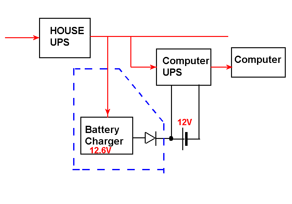

I have a UPS at home - for the whole house. However, every time there is a power outage, my computer restarts. It does not restart when the power returns! I had an old computer UPS that I had that I connected to the computer. Now when the power goes, the computer does not restart - but the computer UPS does not 'recognize' the power coming from the main House UPS. So instead of a 5 hr back up - that the house UPS gives me, I only have a 15 min back up that the computer UPS can give me. I have talked to UPS manufacturers who say they need to fit a 'filter' which will solve the problem. They said something about a pure sine wave output- not sure if I understood. They also said the later versions of computer UPS - like APC will recognize the power coming from an existing UPS. I am skeptical

An AC connected 12V or whatever voltage battery charger, positive output connects in series with a diode, to top up your computer UPS tiny battery and prevent it from discharging. In another word, the battery charger is there to supply all the computer loading and DC/AC inverter loss.
This charger only powered up after the main house UPS has changeover to the internal power.
I'm not sure if I understood Is this an explanation as to why the computer does not restart when the power returns? I'm sorry, but I don't see the solution
Your house UPS is not up to its task in transferring the power, or has difficulty to start up in a short time after main fails.
When power returns, it does not cause a computer restart because its circuit can time the exact moment to transfer the power from internal to external because both sources are available. Nearly every UPS can do that easily.

The battery charger can in fact be a DC power supply, with sufficient current rating. I spoke of battery charger instead because it is more easy for someone to get at what is actually needed.
In fact, it can be a self built or commercial off the shelf DC power supply of 13.8V, with about 10A of output current. I would suggest a commercial 120W one for simplicity.
Rest assure that nearly but all DC power supplies will work happily with AC from your house UPS.

So does everyone recommend Mr. Chung's solution as the best?

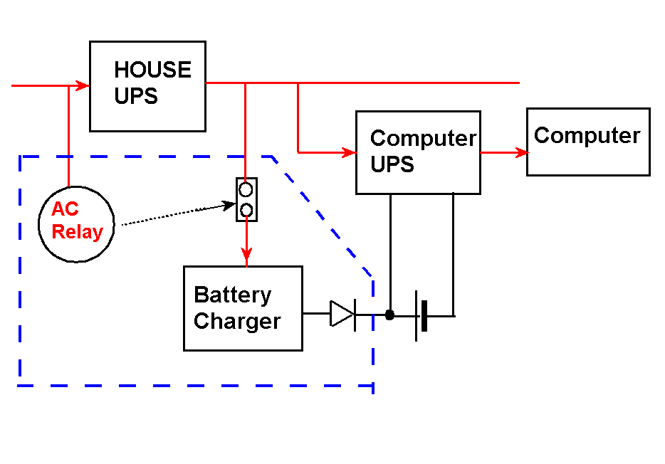

Now you have told us the locations of the two UPSs, I have modified my suggestion to ease your wiring situation.
The difference is now the DC power supply always powered ON and is producing 12.6V output instead of the 13.6V shown previously. The lower voltage used is that it won't mess with your existing computer UPS's own battery charging circuit.

Just to ensure we are on the same page, the computer UPS works fine (charges fine) when outside power is supplied (not from house UPS). Its only when there is an outage that it does not charge - even though there is power supply from the house UPS.
So according to your design, the new charger will have to be connected to the small battery inside my computer UPS - in the manner shown. Have I got this correct? I'm assuming if I show this diagram to someone who understands them - they will understand what needs to be done. Is there anything else they would need to know?
I know I must be causing you to bang your head on the wall by now.... but I really appreciate your patience.
Exactly. The "computer UPS" is relying on the battery power to power the your computer. Even though there is house UPS AC power(non-sinewave), the "Computer UPS" does not accept it to be a good AC source so would not want anything to do with it. It just keep on draining the internal battery giving you 15min backup time.
Except that it will now be a DC power supply(output 12.6V, about ??A, ???W) instead of a battery charger. Its role is to "takeover" the power from the battery and prevent the battery from draining down below +12V. If the battery voltage don't drop below +12V, then the "Computer UPS" will keep on working because it senses the battery voltage to determine when to terminate the backup. No voltage drop, no termination.

On second thought, the option of a new UPS, if working, is a much better solution. You have to work out the cost of the these two options and decide.
You get a new UPS for your computer, confirms it really work with you house UPS or return it for your money back.
You can even specify on your purchase invoice a clause that "UPS must be compatible with non-sinusoidal AC main input" as a condition of purchase.
