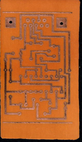

ok, here is how the first one lookes ...i need more practice to get them better.....

Hi bogdanfirst,
That looks pretty good to me.
I take it the parallel row at the bottom
is for a chip?
just trying to get an idea of scale.
9pin DIL ?
Hows that bit at the top,
where the track goes between two points?
is that ok?
John
Hi bogdanfirst,
ive just realised what that top bit is,
its a 'D' connector, right?
John
it is a serial port connector
and here is how i did it....
i printed the schematic to a normal printer but on high quality and resolution. i went to a xerox and copied it and asked for setting the machine on highter contrast and brightness so i get more ink. the paper was what they have, nothing special...
i ironed it starting with small temperature and getting to the hightest for about 5 minutes. i did it twice actually because the first time i didnt iron it well and the lines on the edges didnt come out good. then after i ironed it i put it in warm water and it made the sound like a hot objest in water. i left it for a few minutes to moisture the paper, then i rubber it off with my fingers and all that was left were the tracks. i put it in feric clorhide and it came out....
for cleaning the ink i used a cleaning powder(i couldnt believe it worked!!) and a piece of cloth.
that's it!

I take it you printed your schematic on your injet, then
got a copy from a laser copier on its darkest setting?
I have a Apple laser printer that i will have to see if
i can get working.
Many thanks for describing how you got on,
i will certainly be trying this next time i have to do
a circuit board.
Regards, John
well the first time i tried to print directly to a laser printer and then i tried it but the ink wesnt so great, it didnt come out as i expected. so i went and made a copy of it, not on the darkest setting but on the darkest possible so that i dont have dark page where it was normally white. but i think it works fine on normal too.
and this time worked well.
I will not be using markers ever again!!
Just a tought...bogdanfirst, is this a PCB for the JDM programmer? :)
Hope it works and that you have successfuly programmed the PIC.
yes it is...but now i dont have time to build it.....i hope it works too....still i have to get some pics first....
i am busy for some time but i think that ill start building it after easter....
