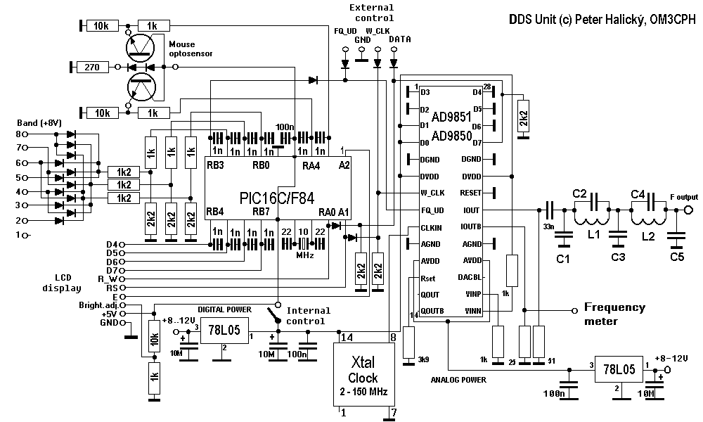

I am eternally grateful to both grandad and les for all their help support and suggestions they are much appreciated. Grandad the circuit for the dds looks simple enough but why are there so many decoupling capacitors on the ra and rb outputs?
The asm files I converted in mplab IDE were downloaded in zip file format . I did a google search, for a dds signal generator with ad9850 qsl.net. If you go onto this site , you will see the circuit I am trying to burn the hex file to .As you can see in this design there are two pic 16f84 chips. One handles the code from a keypad , the other deals with rotary encoder ad9850 control and driving the LCD display.
The rest is merely low pass filtering ,level control agc and buffering of the output. I am curious , to where you found the other dds circuit shown in your last post. Did you ever construct this circuit ? If the offer still stands and you have two pic 16f84's or 84a's available , I would like to see if the code can be burnt onto these chips if possible.If you prefer me to send the two pic 16f84's I have , or merely send you replacements ,either way works for me. As I said before, I really do appreciate your and les's input on this, and do not expect you to do this for nothing. Please advise me either way , on what you would like me to do.

I'm skint at the moment so haven't had chance , to order let alone program the 16f84a chips for my dds project. Just out of interest, does anybody know of a good tutorial about pic programming ,with reference to configuration bits that should be checked,versus bits that should have been preloaded into source code.
Look at the datasheet. It'll list all the configuration bits and explain what they do.
You have a flair for stating the obvious !! Did you even read what I wrote in my last post ? On the data sheet and on countless other websites, it also claims that the pic 16 f84a ,does not support low voltage programming.
That is true. PIC16F84A doesn't support LVP. That's certainly obvious too :)
