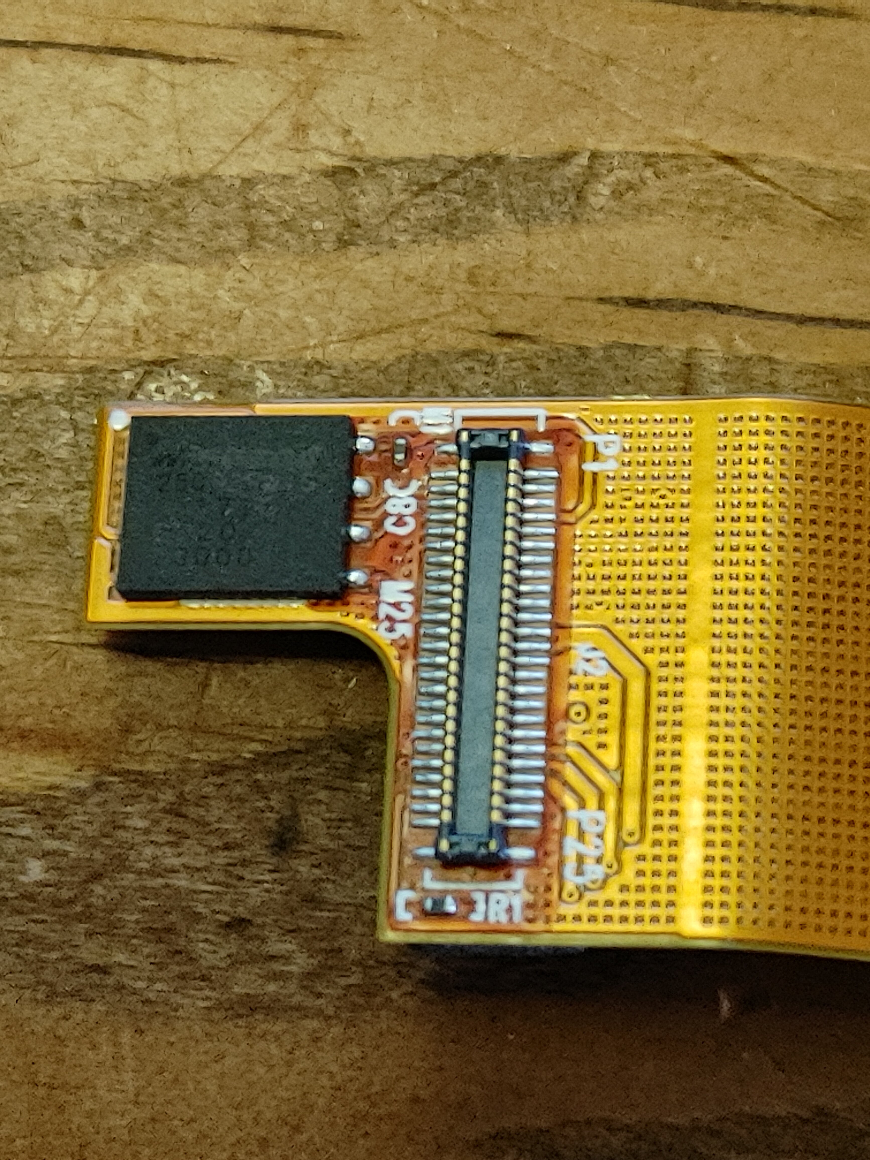

I have all of the hard parts, finally. I should just need to reassemble them, add a few buttons, and then change the code. However, within the process of reassembling everything, I have run into this adapter. It connects a pcb to a small projector, and I need an extension cable so I can put everything where it needs to be. Any help on what this specific connector is called and places where I can buy an extension would be helpful. I have looked for lcd extension cables, but I end up seeing several special specialized connections but nothing identical to this, at least in stock.
