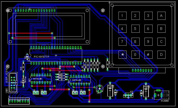

I've had a play with this and got a circuit board built that can drive 2 stepper motors. I'll have a go at getting the hardware built this week and then I may be able to post details.
Sneak peek in attachment.

Hi Mike
Great guns!!! looking forwards to putting it together.
Cheers Mark
Wow, coming along isn't it? Just a matter of time & parts till you have something running. Keep posting as things move along...
Ron

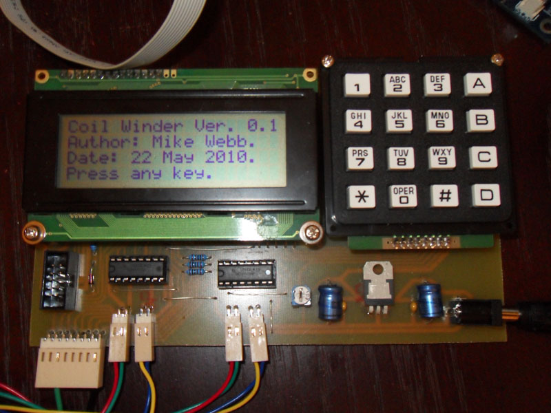

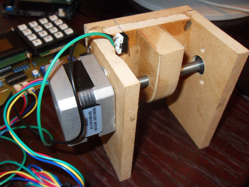

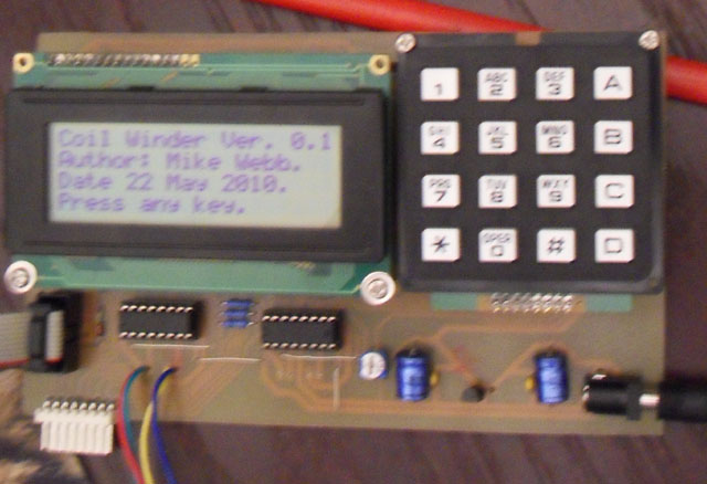

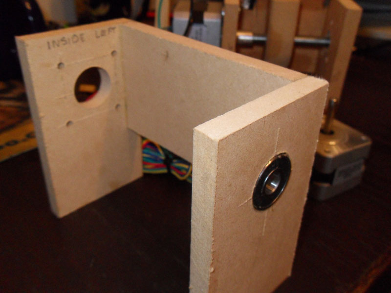

I've not forgotten about this. I built a carriage (attached) but it binded quite badly due to it not being straight. I've half built a second one and should get time to finish it next week.
Thanks Hans for uploading the board etc. If anyone is planing on making their own I did a single sided version with bigger clearances. I'll post the solder side if anyone is interested. I didn't bother with the hall sensor as I planned on keeping track of the number of steps. The attached image of the board shows a 16*2 LCD but it fits a 20*4 as shown on the assembled board.

I managed to have a play with this today and a few problems have appeared. The 16f887 is not big enough and I have severely run out of stack space - solution, ordered some 18F4620. I will run out of room with the free BoostC compiler very soon - solution, going to switch to the C18 compiler.
For anyone curious, this is what it does so far,
And the code so far is attached. It's a bit rough and I had to move the step code inline to keep within the stack limits, hence the very long interrupt. I should be able to tidy it up when the new chips arrive.

Coupling and mechanical details.
Hola Pommie,
Understand that this is still an ongoing project.
How did you manage to couple the stepper to the worm? Are you using bushes or bearings?
From the video I cannot say how you did it. More details you give, the better. Mechanics is not my strongest point.
I will appreciate any information you can give.
