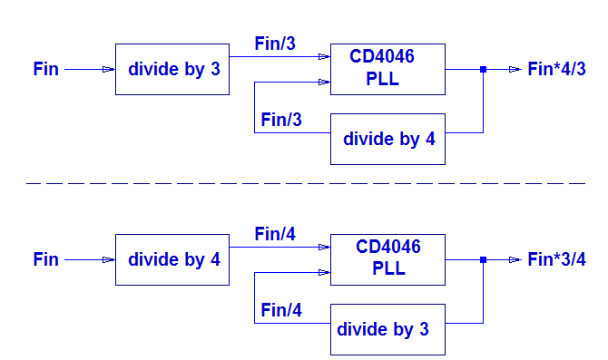

I don't really care how it sounds, it just needs to be divided by 3/4.
Examples: if I put in 24kHz, then I will get out 32kHz.
Or if it is easier to multiply, then I want to be able to put in 180kHz and get out 135kHz.

So apparently you can with start with either note, and you want to generate the other one.
Conceptually, you can do it either way with a PLL and a couple of digital dividers. Below are block diagrams.

Goldsphere: you need a PLL (phase locked loop).
PLL typically has a VCO (voltage controlled oscillator) and a phase detector to keep its output in sync with another signal. Point being, you divide its output by 3 and keep THAT in sync with your input. This makes the system stay at exactly 3x the input frequency. It works with reasonably steady frequency inputs only. If you need something to handle fast transients, you're into DSP territory.
With a divide by 3 in the feedback circuit (this will multiply the frequency by 3) and a dvide by 4 after it, you'll get 3/4 of your input freq.
If you can choose your input frequency though, it might be easier to generate both frequencies by division. Eg start with 100 KHz and divide down to get 1/3 and 1/4 the original.

Thanks everyone for your replies, I will try the PLL and 4017. Was originally thinking of using the 4018, but 4017 is cheaper.
Wasn't too sure about the PLL, cause it is a bit tricky to understand. For instance, what values for the resistors to use if I want to divide over a large frequency range, perhaps i'll set some switches for different values.
Thanks again.

Below is schematic diagram.
The counter N1 plus gate G1 are the divider by n.
The CD4046 phase-locked-loop IC plus divider by m (counter N2 plus gate G2) are the multiplier (*m).
Yes, real counters will work.
A 4017 is not a counter, it is a sequencer.
One of its outputs is at 1/10th of the input frequency for 1/10th duty-cycle.
