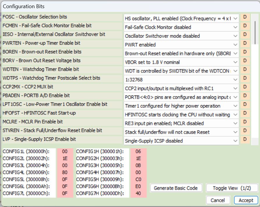

Hi D and I,
Looking through yours and Ian's CODEs, I see that they are all derived from the same source, but have been modified in 3 different styles.
D, your style uses INCLUDES and is very long, and comprehensive, and for me too long.
I think we all should work from the same CODE, and modify it between us, which I think would make life easier.
If you agree, then let's choose which CODE as the BASE.
If each of you would try this CODE, which is distilled from all 3x CODES and if it works, then modify it as you wish, and we can all move forward together.
e,g, this one uses a crystal, so perhaps change it to use the Internal oscillator.
Here: is a link to show it working on my PCB: https://drive.google.com/file/d/1fzzMyRiI9qpuW6v6Yaw1QwLQAbgEcYPH/view?usp=drive_link
EDIT: D, I don't mean to critisize your CODE, as it looks superior, so this suggestion is just for testing, then perhaps we can pad it out later.
C.
'18F46K20 32MHz XTL PCB_9 BASE_MASTER TFT ME #164 291124 1100
Define CONFIG1L = 0x00
Define CONFIG1H = 0x06  '6= EXT8 MHz XPLL = 32 MHZ
Define CONFIG2L = 0x06 'BORV Set to 3.0V  (SBOREN?)
Define CONFIG2H = 0x00
Define CONFIG3L = 0x00
Define CONFIG3H = 0x81  'Set for HVP
Define CONFIG4L = 0x80
Define CONFIG4H = 0x00
Define CONFIG5L = 0x0f
Define CONFIG5H = 0xc0
Define CONFIG6L = 0x0f
Define CONFIG6H = 0xe0
Define CONFIG7L = 0x0f
Define CONFIG7H = 0x40
Define CLOCK_FREQUENCY = 32

Hello; with the fuse configuration you use your code does not work for me, so I changed the fuse configuration to work with external crystal x 4PLL, then I changed some parameters to orient the screen and the text because it is not exactly the same as yours.
I have noticed that if the text string is longer than 17 characters it is cut off. I am reviewing the code but for the moment I have not found the problem.
Edit (2025/01/12):
Fixed the problem when writing text.

This is the configuration to avoid problems during testing. If your PCB has a reset button you can enable MCLR:

Update, thanks. Will you let me know also the differences in the CONFIGS 2L, 2H, 3L,and 3H please.

Hi C, here’s a description of the PIC18F16K22 fuses:
' Fuse Configuration:
' Crystal 10 MHz x 4 PLL = 40 MHz, MCLR = On (External Reset)
#define CONFIG1L = 0x00 ' Configuration bits for oscillator and memory settings
#define CONFIG1H = 0x33 ' External oscillator with PLL enabled
#define CONFIG2L = 0x1E ' Brown-out reset and power-up timer enabled
#define CONFIG2H = 0x3C ' Watchdog timer settings
#define CONFIG3L = 0x00 ' Low-voltage programming disabled
#define CONFIG3H = 0xBD ' Port configuration settings
#define CONFIG4L = 0x80 ' Stack overflow/underflow reset enabled
#define CONFIG4H = 0x00 ' Reserved bits
#define CONFIG5L = 0x0F ' Code protection settings
#define CONFIG5H = 0xC0 ' Data EEPROM code protection
#define CONFIG6L = 0x0F ' Write protection settings
#define CONFIG6H = 0xE0 ' Configuration protection bits
#define CONFIG7L = 0x0F ' Boot block protection enabled
#define CONFIG7H = 0x40 ' Configuration settings for block protection
I usually stick to the default configuration, only adjusting the settings related to the oscillator (type and frequency in MHz). I ensure that options capable of generating a reset to the microcontroller are disabled, which is typically the default setting.
During project development, I find this initial configuration to be the most stable. Once the project is complete, I adjust the settings based on the environment where it will be installed. These adjustments are rarely critical because I incorporate various protections into the PCB, such as anti-parasitic suppressors, a high-quality power supply, proper component placement, ground planes, and so on.
If you ask me what CONFIGS 2L, 2H, 3L, and 3H are, I don’t usually take the time to analyze them. I just go into the fuse configuration window and enable or disable the options I’m interested in. Remember, in this window, the fuses are listed by description rather than by numbers. Also, every time you change a value in the fuse configuration window, the corresponding configuration word at the bottom updates and shows its value in hexadecimal format.
