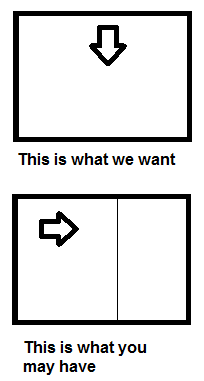

Hi C.
Watch the loading.. here are a few piccy's.
If you watch the way the screen is drawn ie left to right and stop
Change MADCTL to 0x28 If the text is backwards then let me know
so the whole screen? The MADCTRL is the memory address control.
first we want to control the vertical and horizontal refresh direction so the both need to change
here is the MADCTRL settings
Bit 7 = MY Row address order
Bit 6 = MX Col address order
Bit 5 = MV row / col exchange
Bit 4 = ML scan top to bottom or bottom to top
Bit 3 = BGR / RGB
Bit 2 = MH scan left to right or right to left
so the two bits needed are MH and ML try 0x38 to swap top to bottom then 0x3C to swat left to right

Hi I,
No difference, but the ILI9341_MADCTL_?? section doesn't seem to be used in the program
