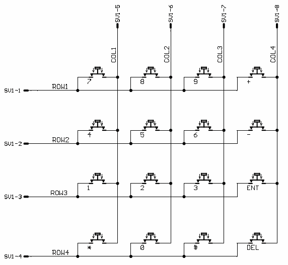

I posted some simple keyboard code on this thread. I now realize that this same technique can be used to make a combination lock with an 8 pin pic. Just not had time to play with it yet.
Using a 3 x 4 keyboard and a 4 bit LCD doesn't leave any pins left to opperate the lock.
Use a pic with more pins. 16F876 for example.
(based on my experiences using Nigel's tutorials)
Nigel uses all of PORTA which leaves port B, 3x4 = 7 pins and one left over to control a transistor to control the lock relay. The 16f628/a would work fine.
Here is the 4X4 matrix for the keypad.
E.g. if button "6" is depressed row2 and column 3 are shorted.
