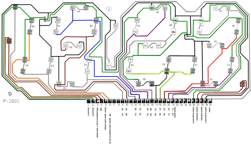

I was having trouble find something to use for the display when I realized I have a display from an old Radio Shack clock that should work. The attached image is an actual photo of the display with the plastic cover taken off, and the lines cleaned up so I could follow the circuit.
Each segment consists of two led's in series. The segments are connected in groups of two. Half to one ground, and half to another.
The original ran off a 12V transformer which I intend to repackage as a separate unit with short cord to a plug, and long cord to the clock.
I'll have to drive 11 segment groups + colon + am/pm indicator + alarm on indicator + 2 grounds, for a total of 16 lines.

You would use some type of multiplexing to drive the individual LED digits (saving on i/o lines); your LED display seems to be 3 1/2 digit but the interconnections seem a bit weird, to me anyway. Have you confirmed them, by trying to light up particular LED segments with a multimeter or low voltage?
Ok, think I worked it out, got lost following the traces. and, yep, it's already multiplexed, Doh! Carry on!

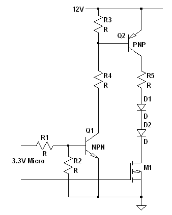

You could use an NPN emitter-follower, or an NPN driving a PNP. In the former, most of the power is dissipated in the NPN; in the latter the series resistor (the one in line with the LED) will handle the brunt of the wasted power.
LED displays are fine with the mains-operated supply but will gobble up batteries pretty fast. Presumably when running from battery the display would only be on when a button is pressed?
Expanding on dougy's suggestion (post #4), here's what the NPN/PNP option would look like:

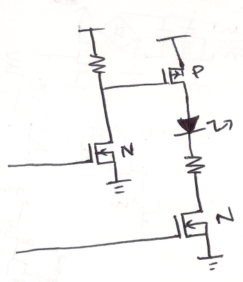

Using some mosfets gets reduces the resistor count

Oh, and there's always the NPN emitter-follower configuration mentioned above, which only requires a single NPN transistor without a base resistor. It's certainly simpler.
How does that work with a 3V input, dougy? To get 12V onto the LEDs wouldn't you need a base voltage of 12.6?
Yes, for 12V output you'd need 12.6V at the base, but for 2.4V output, 3V at the base is fine. The current limit resistor (LED series resistor) could go between the collector and the 12V source.
