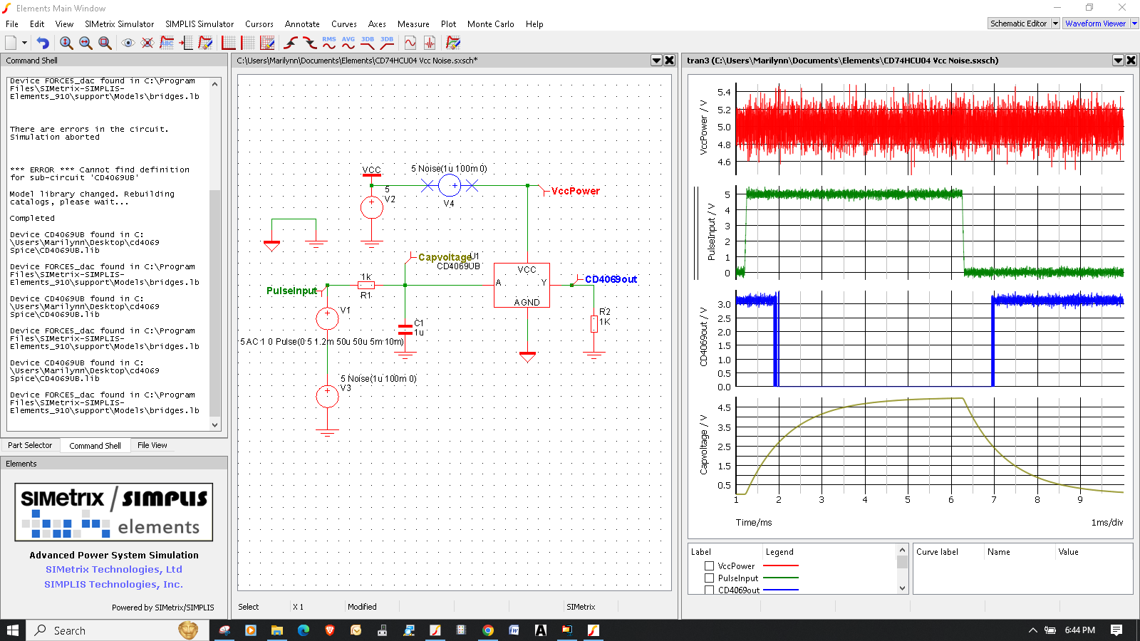

I don't get it. Your simulation doesn't look anything like what I showed.
I really don't think I need a Schmitt trigger here.
Forget the sim, read the ap notes on slow Tr and Tf in CMOS.
Setup and hold times are affected by that input.....
Almost forgot direct coupling of power supply noise and transients
into reset pin great idea.
Why using RC slow Trise, Tfall :
As you can see there is a lot of jitter in gate output. That can cause metastable states in
the downstream clocked logic.
Easy to use is single gate logic Schmidt trigger gate that cleans up this using hysteresis internal.
Regards, Dana.

You might check a single shot capture of your reset pulse differentiator
time constants. This sim used a 10 mS ramp for power on, as you can see
no real reset pulse was generated. If supply has small bulk caps, and is
much faster then a decent pulse is generated.
Note sims are behavioral, not transistor level, so bench chk is really mandatory.
Just a single shot level trigger should capture and confirm what you have.
When sim was rerun at 10 uS ramp on Vcc a decent pulse occurred.
Attached handbook good section on terminating CMOS inputs and other considerations.
Regards, Dana.
