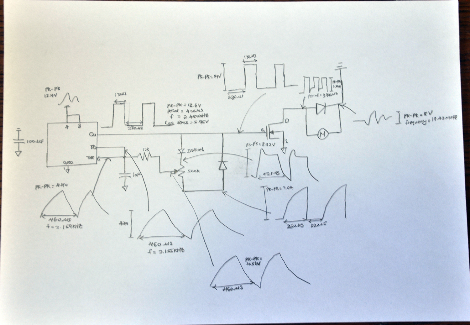

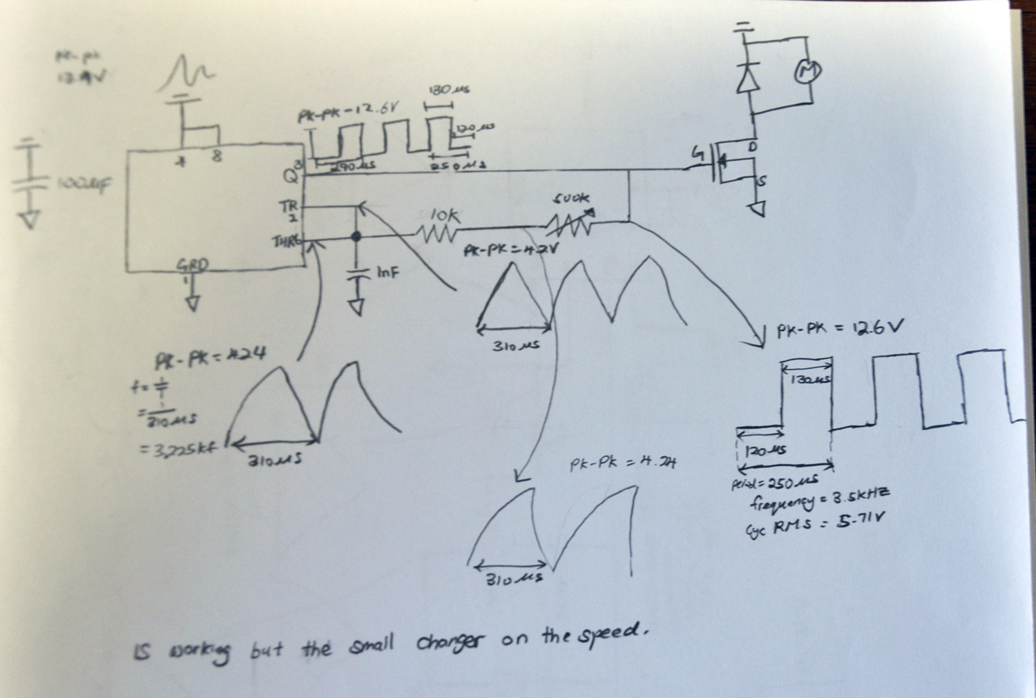

i'm doing a PWM motor control circuit..
i have a problem with the PWM ADJ part.. i would like to know the difference between the circuit with and without diode? and y does the circuit diode works better?
diagrams shown in e attach doc.

You did not attach the entire oscillator circuit so your pot with diodes are almost meaningless.
If the oscillator is a 555 IC then the diodes allow separate charge and discharge times for the timing capacitor.

i attach e circuits here
thanks

Your schematics do not have a part number for the IC but it looks like an NE555 circuit.
The first one changes the duty-cycle of the rectangular-wave output so it produces PWM. Its frequency changes a small amount.
The second one does not change the duty-cycle of its rectangular-wave output so it does not produce PWM. Instead it changes the frequency. Some DC motors change their speed a little when the frequency is changed a lot due to their inductance.
Your power supply symbol looks like ground.
Are you using an AC power supply?
A battery does not have a fluctuation of 13.4V pk-pk.
He's using the same symbol at his transistor, which seems to imply a DC supply. Confusing.
Where is he indicating this symbol represents a 13.4 V pk-pk voltage? I only see waveforms indicated at the outputs of the 555, not the supply voltages to the IC or transistor. Am I missing something?
I'm still guessing th double lines (one short, one long) represent a single cell battery, like they are supposed to in a proper schemy....which would be just another way of indicating a DC supply of some indeterminate value.
....But I will admit I see pins 4,8 have a waveform drawn and he pk-pk value. If he means for an alternating pulse to be applied here, he shouldn't confuse his drawings with DC symbols. Bad practice.

And wyl86, your symbols for ground and positive supply are backwards.
