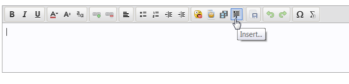

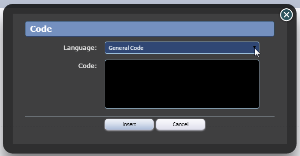

That looks a bit like BASIC, but I have not used BASIC before. Also, PLEASE use code formatting. We have code tags here for a reason.
Hi Matt
I have to say, I would have done exactly the same because I don't know about code tags either .. .. .
Would you be kind enough to enlighten me Pls ?
S
Code tags!!!! This is what I type...
The "code" tags can equal C, basic, text, PHP or many more... The "C" gives the C syntax highlighting ( colours )...

Sorry guys, didn't occur to me that people may be unaware of how it works.
I generally use the "insert" menu:
You should be able to use the dropdown (that defaults to "General Code") to select your language. However, I just noticed it only offers the options for PHP and HTML, while it supports a lot of others. Wonder if this is a bug....?
Ian's method seems to be the most effective at this point.
