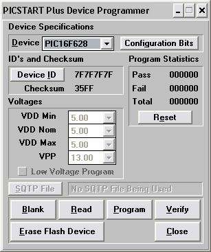

hi, i'm a newbie in pic programming. i'm now trying to re-program a pic using microchip mplab ide and pic start plus. i try over and over again but still, it shows the error message because the pic's program memory is NOT BLANK. what can i do to force mplab to erase the pic's memory?

im using pic 16f628, my programmer is pic start plus. i try to use another DIY programmer, it works! but not mplab, i wonder why? ( there's no selection for erasing the eeprom in mplab )

Have you tried pressing the "erase flash device" button under the PICStart Plus dialog?
yes, i did try it! my mplab version is 6.2.0, i wonder does it support 16f628a?
OOps sorry. I forgot to mention that the screenshot came from mplab 5.7. I am having problems working with the newer version 6 series so I'm sticking with the 5.7 for now.
