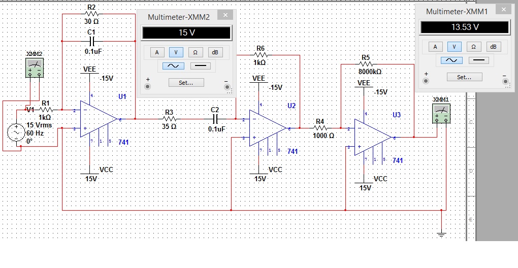

Attached is a picture of my multisims but I still have not obtained a gain of 7. Could you please help again?
Use a newer op-amp than the 741, try a TL071.
Your input signal is 15v RMS, a gain of 7 would give an output signal of 105v RMS.
Your supply is only +/- 15v so your input signal is FAR to big. Try 1 volt or less.
Some of the resistor and capacitor values look a bit odd, maybe worth re-checking.
Actually, looking again at your circuit, it looks all wrong.
Read Joe Jesters application note and try again.
You need to figure out how to get that toy simulator you are using to do a Bode plot (frequency response) . You are driving your proposed circuit with 60Hz, instead of sweeping the frequency from ~1KHz to about 1MegHz.
As Jim said, you are overdriving the input.
A 741 amplifier does not even come close to having sufficient gain-bandwidth product to do this job.
The values used in the input and feed back at the opamps are way off. Try to constrain them to be between ~10K and 1MegOhm.
There is no need to have a third opamp to get the gain. Set up the HP and LP sections so each has a small gain such that Glp*Ghp = 7.

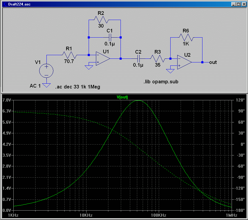

I took your circuit, changed one resistor, and here is the Bode Plot showing a gain of 7 in the pass band. You still must change the design to get more reasonable values for R1,2,3 and 6. Note that I am driving the input with 1v and getting 7V out. How did I do that?
Also, if you look at the Bode Plot, you are not getting the filter rolloff sufficient to be at 0.707*7V at 45kHz and at 55kHz. You will need to use a at least a 2-pole filter for each the HP and LP sections, for a total of 4 poles...

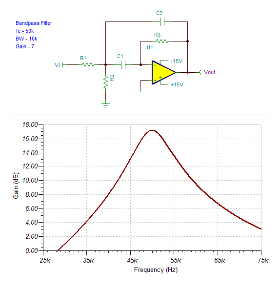

I also think he needs to lookup multiple feedback bandwidth filters for this assignment. He can read more about them at https://www.circuitstoday.com/band-pass-filters

Look how simple, intutitive, clean my LTSpice sim of his proposed circuit is compared to that horrible Multisim schematic
That is a 1st order bandpass filter. I thought you needed at least a 2nd order filter?
You have the lowpass filter with a 30 ohm resistor and the resistor for the highpass filter is only 35 ohms but the datasheet for a 741 opamp and for almost all other opamps show a MINIMUM load of 2000 ohms. Your load is 30//35= 16.2 ohms.
A simple calculation shows that your input resistor of 1k ohms and feedback resistor of 30 ohms produces a gain for a POWER amplifier (not an opamp) of 0.03 times so the output will be 0.45V for low frequencies.
If the opamp for your highpass filter is also a POWER amplifier then its gain will be 1k/35 ohms= 28.6 times for high frequencies. But it must be an amplifier that works at 50kHz. A 741 opamp is not a power amp and it does not work above about 9kHz.
Your output opamp would have a gain of 8 if you selected an opamp that works at a frequency as high as 50kHz.
I do not know why you are feeding 60Hz to the circuit.
