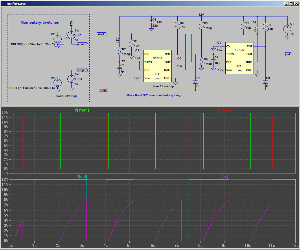

Try this:
I think it does what you want. Note that I try several cases of relative timing between Start~ and Stop~.
I made the R2C2 time constant shorter than what you asked for my convenience, but you can make it anything you want.
The diodes can be 1N914 type.
Try this:

Actually, C5 and R4 is a differentiator. D1 clamps the positive going edge. R3 and R5 turns the second 555 into a set-reset flip-flop.
I stole Mike's AC block cap method to make things edge-triggered and it seems to work in full now.
Well, whatever I thought you did works the way I thought it would work for me circuit haha.
Maybe a differentiator is what it really is. I looked at it and thought of it as a AC-pass cap that would convert changing level signals into a transient edge signals with a pull-up resistor to bias it to the idle state when there was no activity going on.
I was wondering what R3 and R5 were for and am still don't get how they're doing what you say they're doing since it just seems like it's biasing the threshold pin for no reason
...I was wondering what R3 and R5 were for since it seemed like you could just tie the threshold to ground...

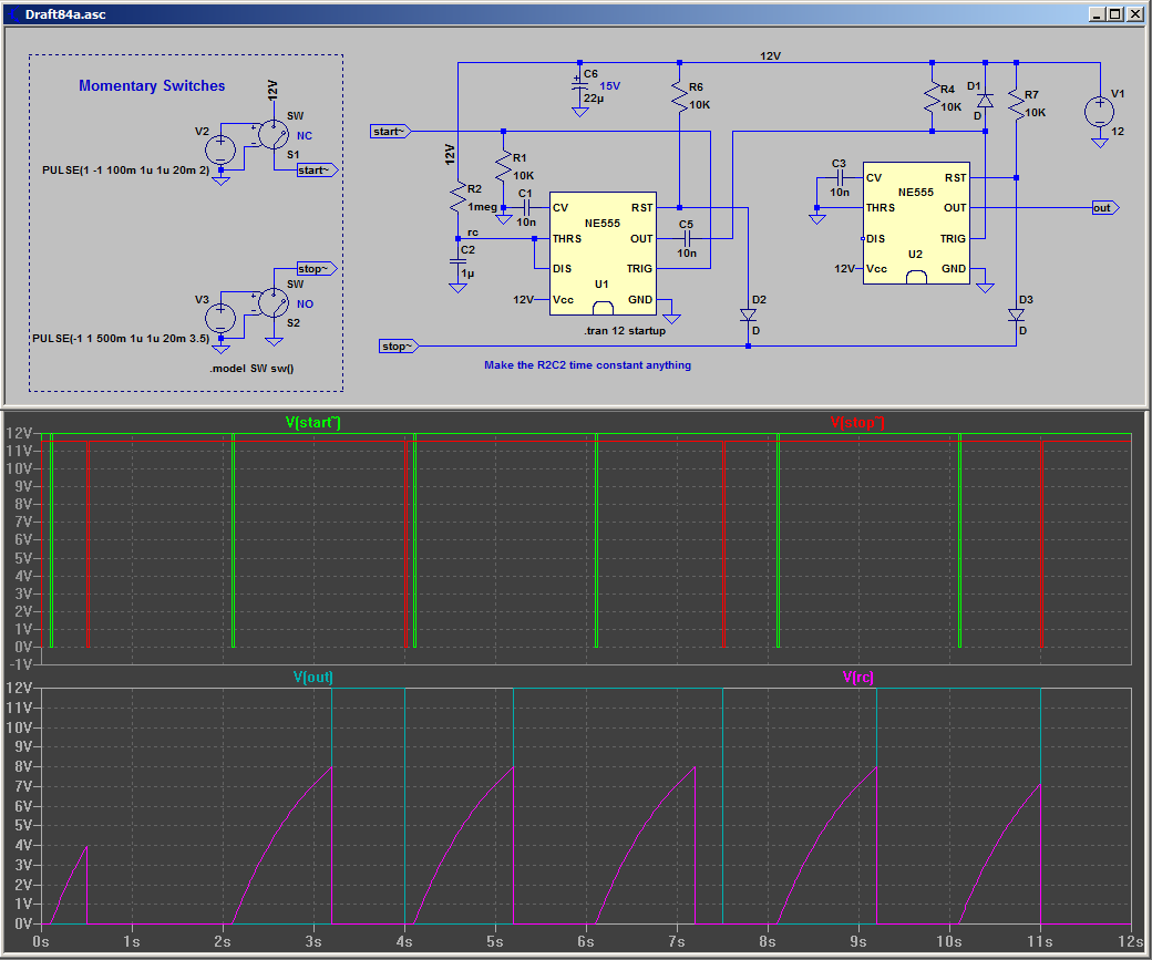

Yep:
A few less parts.
Here is the .asc file incase somebody wants to play...
