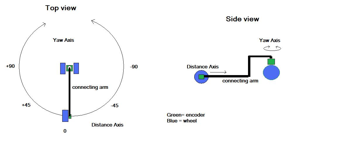

First question:
With two feedback devices, ones measures distance and the other measures the Yaw axis is it possible work out it's X,Y location?
Tommy
The quick answer to your question is YES.
Have a look here:
Polar and Cartesian Coordinates
You seem to have some application in mind, whether this will work for what you are trying to do, I am not sure.
Hi there,
This is possible yes but there are some accuracy issues to be aware of.
Note that when the angle is close to 90 degrees for one small change in angle A we get a sweeping distance (along the x axis) of some length xL1 but a much smaller distance along the y axis yL1, and when the angle is close to 0 degrees for that same small change in angle A we get a sweeping distance along the x axis of some small distance xL2 but a much larger distance along the y axis yL2. When the angle is close to 45 degrees on the other hand we get nearly the same distances in the direction of x and y for that same small change in angle. These differences mean that the accuracy in different areas for pointing out a given point (x,y) in the working field is going to vary sometimes quite a bit over the whole range of the device, and this accuracy has to be checked to make sure it works well enough with the application as needed.
