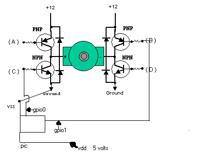

You need to show your circuit it should be something like this but your using the L293 for the bridge. Use 1k resistors from your pic to motor input.

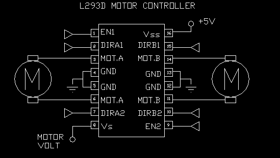

here a drawing of the L293D with 2 motors the pic is from

these two inputs are fed to the l293 as per ur above figure.

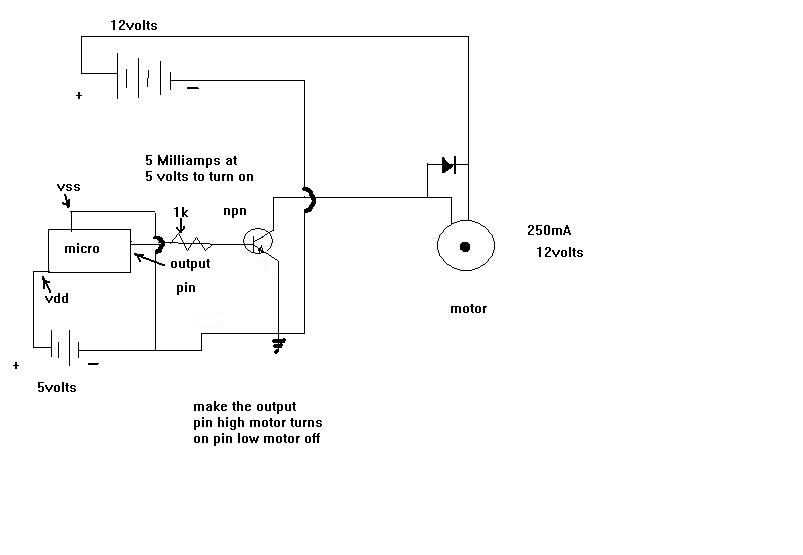

The H-bridge is to power the motor. With the right H-bridge you can power any
motor with your micro controller. Your micro controller is to turn on the H-bridge . It doesn't take much to turn it on your using 4.5 volts for high and 0to 1.5 volts for low. You only need .2uA to turn the bridge on. If you would draw out how your setup is it would be easy to tell you what to do from what your saying your going to burn up your micro controller
this is for you micro

Take a look at this maybe it will help you see how a transistor can
switch a motor on and off at a higher volt then your 89c51 and more current
you can burn up your micro by pulling to much current out of a pin or sinking to much in.
