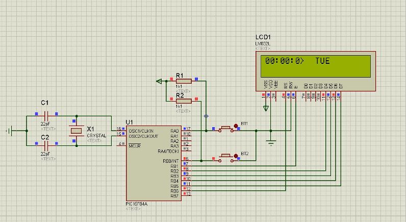

I have designed an LCD clock based on PIC16F84A , the program works this way :
I have two buttons , when i click the BT2 , i get LDC binking ( 3 fast blinkings) for 3 times each time is a preparation for a specified setting .
Preparation one : minutes .
Two : hours
three : Days
For example in the first blinking i need to keep the BT1 pressed to adjust minutes before the first blinking ends , if i do nothing in that first linking , i get another blinking , but this second one is for hours .and so on for days .
Now the problem is only in the days settings , when i get the third blinking specifically for day adjustment , i can adjust days but i get weard characters in the seconds right digit , its like when that digit reachs 10 it keeps incrementing and does not get back to zero .
I only got that problem when i used the TMR0 interrupt witch i configured using the OPTION_REG register to have an exact 1 SECOND for the clock .
Here's a picture of the glitch accompanied with program text :

But j is just a variable for counting 7 days , from 0 to 7 , other variables are written in ASCI2 to be recognized in the LCD display .
Sorry , the problem i got is when i adjust days , when i do that , the seconds right digit gets incremented without getting back to zero , it continues to display other characters of the ASCI2 .

OK!! The problem is with the lines
C:
Lcd_cmd(_lcd_clear);delay_ms (500);Display (); delay_ms (500);  Lcd_cmd(_lcd_clear);delay_ms(500);Display();delay_ms(500);
You have 500 * 4 + LCD function delays WITHOUT error checking that 2 seconds that the clock is bieng updated without being processed.... You need to stop the interrupt while the clock is being changed...

Sorry its from 1 to 7 indeed , ian rogers is right if i disable the TMR0 interrupt only the code works fine , but i need to implement the timer to have an exact 1 SEC .
So according to you should i put TMR0= 0; on the adjust section ???
Its fine... You don't need the timer while you are adjusting the time... The line in question has more than a 2 second delay... so clearing timer 0 won't help... Just disable the interrupts while r is on..
In the interrupt code you simply do "s1++" without checking for overflow. While you do your adjustments, the interrupt may be called several times without the "if (s1==58)" code being called from the main(). This may cause an overflow in s1.
Hey thanks northguy , i have edited the timer 0 interrupt , and got rid of that problem but i can't adjust days .
I have edied the code btw.
I cant clear interrupt while r is on , r is part of the interrupt
No it isn't... Its only used as a "Setting switch" As long as the interrupt catches your input.. You are clearing r at the end of the "setting" while statement...
Thanks ian for the comment , i have already got rid of that s1 overflow , but another problem occurs , i can't adjust days after that .
For now i will dig more into my code and see if can find a sollution .
I was running it on ISIS and it was working just fine.... I disabled the interrupts and I could alter all three values...
