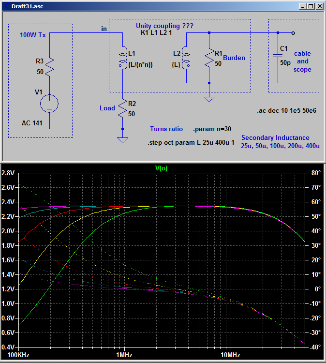

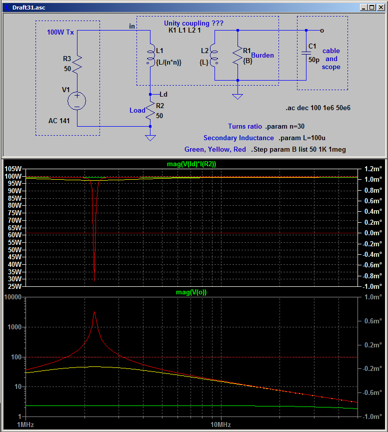

So here is a hack. Note I reduced the burden to 50Ω (BNC coax termination). This suggests that any ferrite core that would make a secondary inductance of 25uH to~400uH with 30turns on it would be usable. I would like the CT to work from ~1Mhz to ~30MHz. The loss in L1 is insignificant in a 50Ω system. Green trace= 25uH, Violet trace =400uH
The high-freq roll-off is due to the reactance of the shunt capacitance C1 relative to R1. The low freq roll-off is due to the reactance of L2 relative to R1.
Please critique...
I'm not sure where the 1mH in the primary came from? I figure a max of 400uH/(30^2) = 444nH, less than 1/2000 of 1mH.

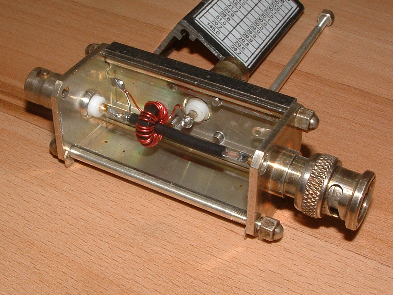

For a low frequency 50/60Hz current transformer, the accepted wisdom is that if a current passes through the primary while there is lo load on the secondary, then the transformer will be damaged and the world will come to an end (worst case scenario).
I have never considered the case of an RF current transformer, as used in an ndB coupler, such as this home made 30dB coupler of mine:

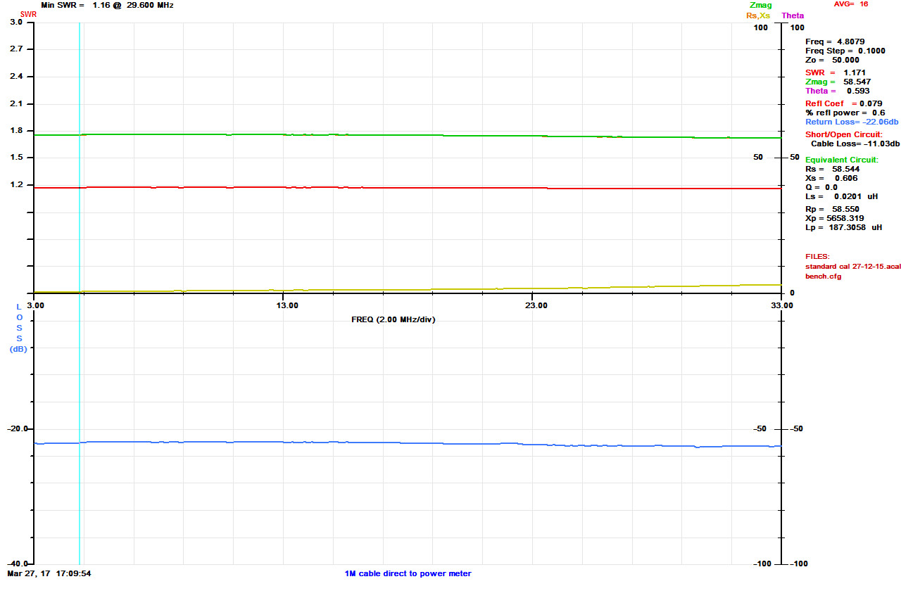

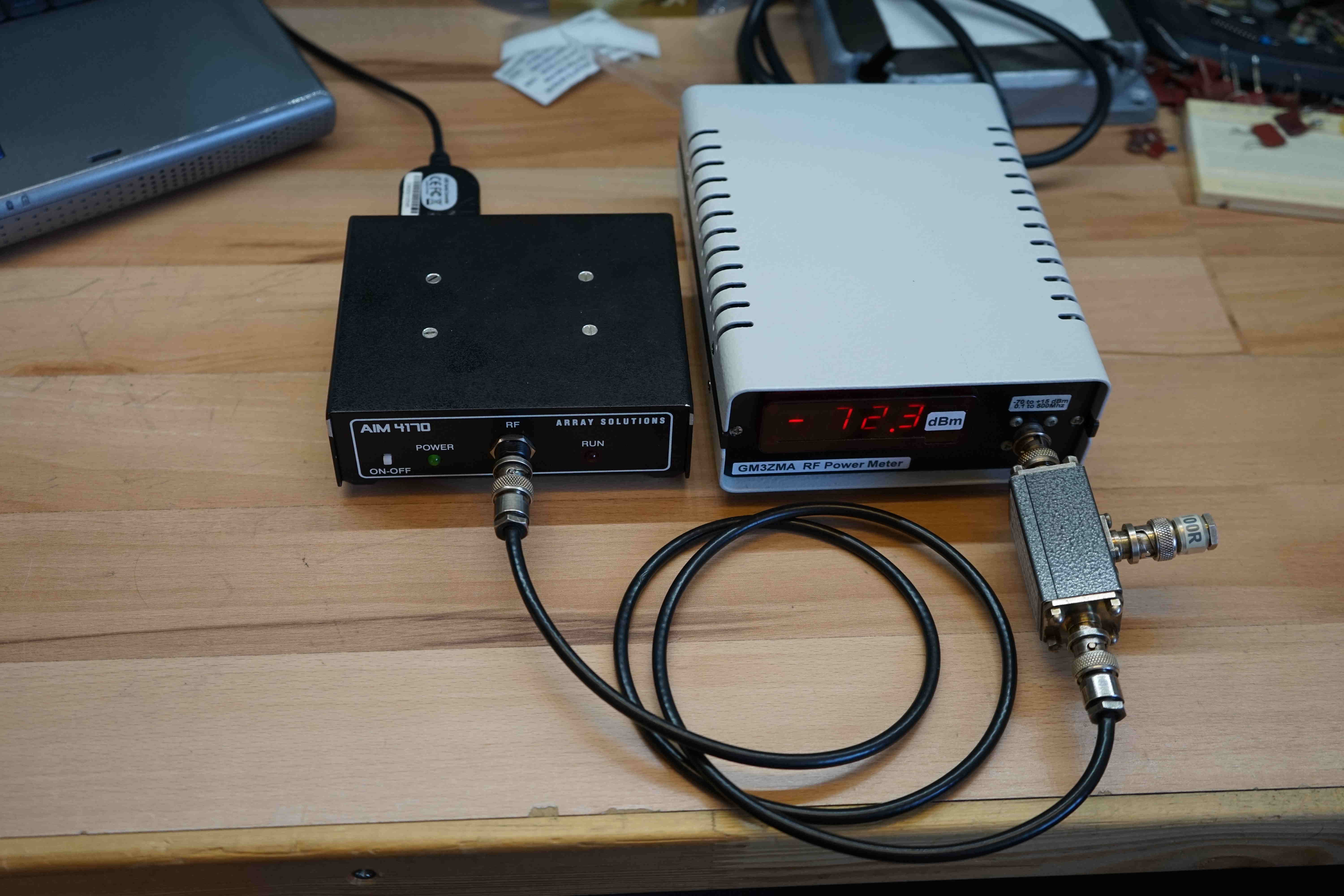

So I did some tests using a signal generator (HP8640B), my 30dB coupler and my home made RF power meter which is based on an AD8307.
I set the sig gen to 10MHz 0dBm, and connected via a 1metre long coax cable to the power meter. The power meter read -0.3dBm

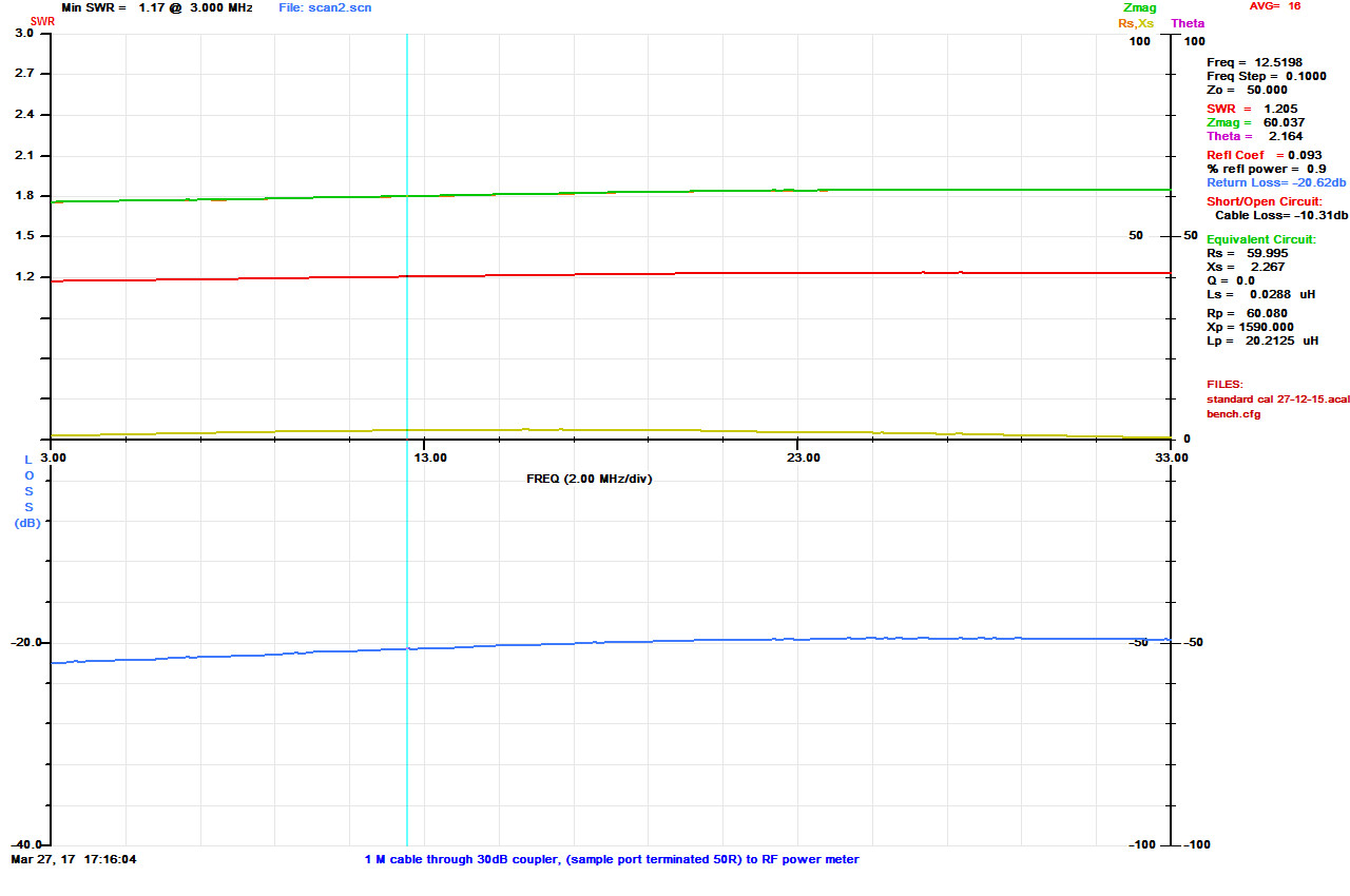

I then inserted the 30db coupler at the power meter end of the cable. The coupler was terminated with 50R on its sample port. The power meter again read -0.3dBm.

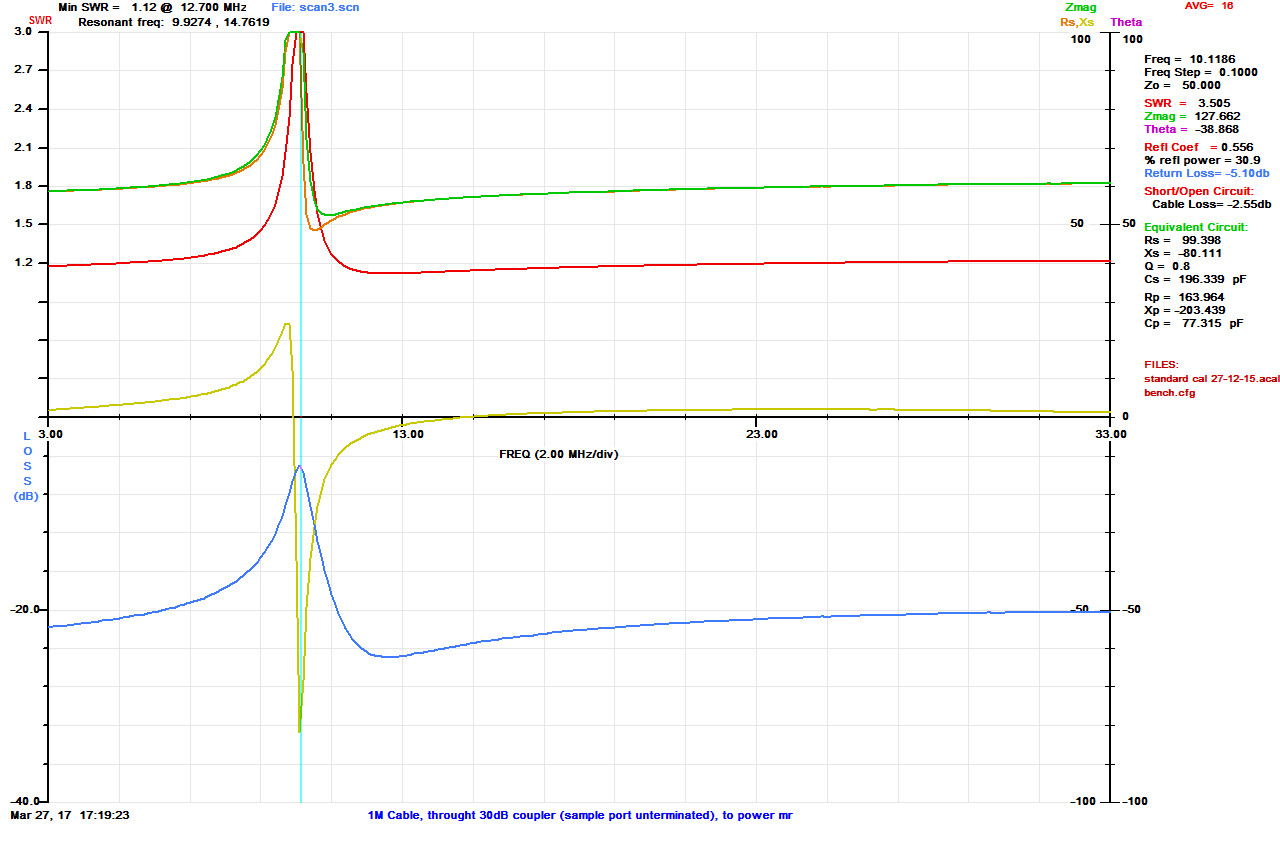

I then changed the load on the coupler sample port, and got the following results:
Load Meter
Open circuit -4.3 dBm
Short circuit -0.3 dBm
100R -0.3dBm
Clearly something odd is happening when the couple sample port is open circuit.

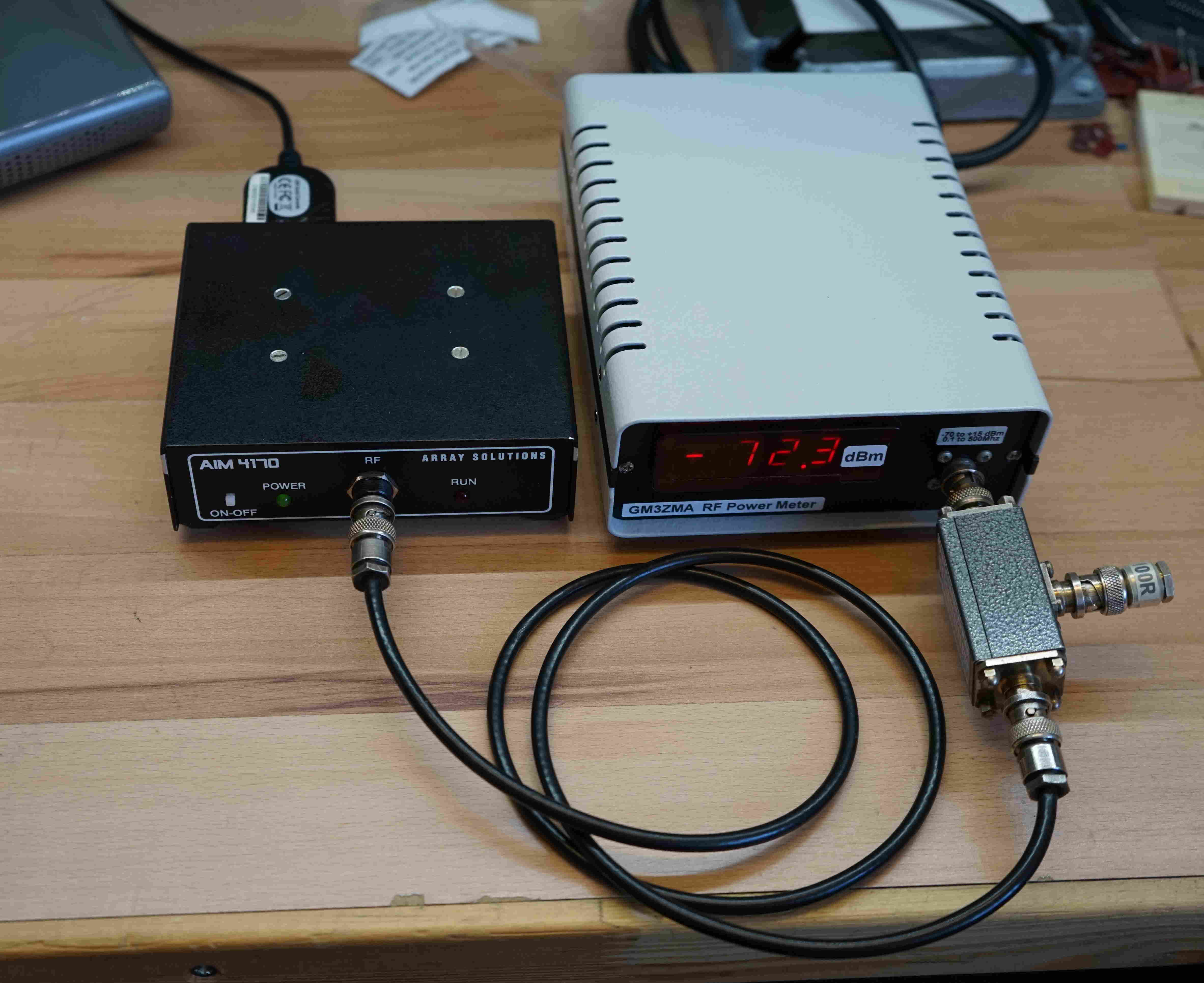

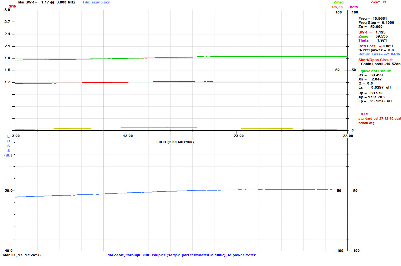

To investigate further, I used an AIM4170 Antenna Analyser (a simple form of a Vector Network Analyser), connected up like this:
Sweeping the frequency from 3 to 33 MHz gave the following results:
Looking directly at the input of the power meter, a nice flat VSWR / Return Loss from 3 to 33 MHz.

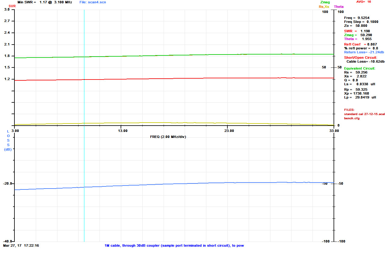

With the 30dB coupler at the input of the power meter, again a reasonably flat VSWR / Return Loss from 3 to 33 MHz.
With the 30dB coupler sample port un terminated (open circuit), something serious is happening in the 10MHz region.
With the 30dB coupler sample port terminated with a short circuit, we are back to the fairly flat response.
And similar results when terminated with 100R.
It is quite by chance that I started the experiments with the signal generator giving 10MHz, I thought that it was a low enough frequency to give good results when looking at the 30dB coupler sample port with a 200MHz scope.
I have not included my scope test results here, but I did see quite large voltages when the coupler was unterminated.
What I did notice was the voltage on the sample port was very dependant on what was connected to the port, even just putting a BNC "Tee piece" could make a visible difference. I guess the small capacitance of the T piece was enough to affect the high impedance of the unterminated sample port.

So I set the secondary inductance to 100uH, and then show what happens with different values of Burden resistor; 50Ω (grn), 1K (yel) and 1meg (red). Top plot pane is power delivered to the load, bottom pane is the output voltage.
As shown previously, the CT works well with B=50Ω; nice flat response and the load gets close to 100W. (grn traces)
With the burden being only the 1meg input impedance of the scope shunted by a bit of cable capacitance it resonates with the secondary inductance and we get a huge voltage out at the resonant frequency. Note the power delivered to the load has a huge notch at the resonant frequency. Isn't this what Jim measured near 10Mhz? Since the values I picked for C1 and L2 were a wag on my part, I'd say the sim comes remarkably close to what he measures in a real circuit.
The 1K (yel traces) is some where between the two cases above, still showing resonance, but with a much lower Q.
Thanks guys, I learned a lot from this...
I think it looks very much like I measured.
