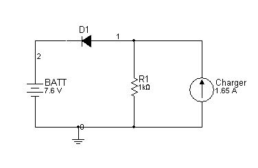

hello all, well here is my scenario, i have these battery packs that are recomended to be charged at 950mA rate for 3hrs, i have a charger that charges at 1.65mA max rate with a voltage that it seems to step up starting from 7.83V to a max of 8.36V at the time it switches to green. However this charger is a pulse charger and its current varies but I will like to limit its max to idealy .95Amps now I was looking at some voltage regulators that have a max current of 1amp but with a set regulated voltage, I was just thinking maybe a mosfet and some resistors to control the current going into the charger but its this a efficient solution, ... any suggestions will be helpfull i am willing to try different things ... as that's is what i am doing now

Could you just strap a resistor in parallel ? I mean work out the peak voltage on a pulse and choose a resistor to sink the unwanted half an amp ? You might need to involve a didoe to prevent the battery flattening throught the resistor when the charger stops charging.

Connecting a resistor isn't such a good idea, because the resistor limits current by producing a voltage drop, which you don't want when charging batteries. You want a current source.
EDIT: I noticed you said in parallel, not series. But the battery impedence is not constant, so that would mean the current would change too. A resistor in parallel could also possibly cause the battery to discharge through the resistor in some cases. It's similar to hooking two sources and a resistor in parallel.
