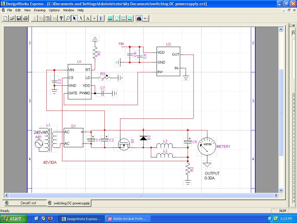

Heres my first attempt at designing a circuit! Most likely theres a heap of problems that will let it only make smoke as it is:)
With the experienced help from here im sure we can get it to work. Just let me know what to change a little at a time.

the AC source is not connected and C1 is shorted on the schematic, but since you are not making a PCB from the netlist I am sure you will be able to work around that. :)
the LD pin needs to be a voltage input from 0.5-2V for linear dimming, it actually sets the peak current. You are showing it as a simple variable resistor to GND.
R1 should be terminated to the gate pin of the IC and not to GND. this changes the regulation mode of this particular chip to peak current constant off time instead of constant frequency. this allows good regulation at duty cycles over 50%. Sorry I thought I had posted the link to the app note but it does not look like I did: https://www.electro-tech-online.com/custompdfs/2008/05/AN-H50.pdf
Early in the discussion it tells about the disadvantage of current mode regulation and explaining that constant off time takes care of it and gives figure 4. the rest of the document goes into the design formulas.
Tie U1 Vin to 18V instead of 360V. The chip is capable of running that way, but it is unnecessary dissipation when you have a lower voltage rail available. The internal linear regulator is there for running LEDs off line with out extra parts.
You do not say how you are obtaining 18V. A 12V transformer can easily reach 25V under no load conditions. 20% for regulation (small transformer spec), 20% for line variation under normal (not fault) conditions, and 40% from RMS to line peak. That is sufficient to blow U2 and the FET.
That is all I am seeing off hand.

oh dear, the meter location confused me. the low side of C1 is circuit ground as well. the sense resistor goes between the FET source and GND. the output is between L3 and D2. C5, if needed (I was assuming so for noise), would be across the load.
See figure four of the app note.
Im a little unsure of this, i tried to draw it up as you have said to here, but something just doesnt look right.
Where does the other end of L3 go to?

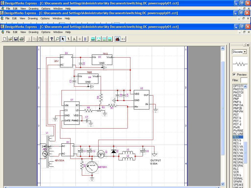

Revision 1 :)
Ive added the 12v and 5v supplys., changed the 18V to 12V so i can run a fan from it if needed.
Moved the meter to the neg rail, as the resistance of the meter can be utilised as part of the resistance needed for current sensing, so R2 may not be needed.
Still unsure of the location of the Inductors....:confused:

Would you PLEASE look at the app note!!!! The output is ACROSS C5 and R2 is in SERIES with Q1 source

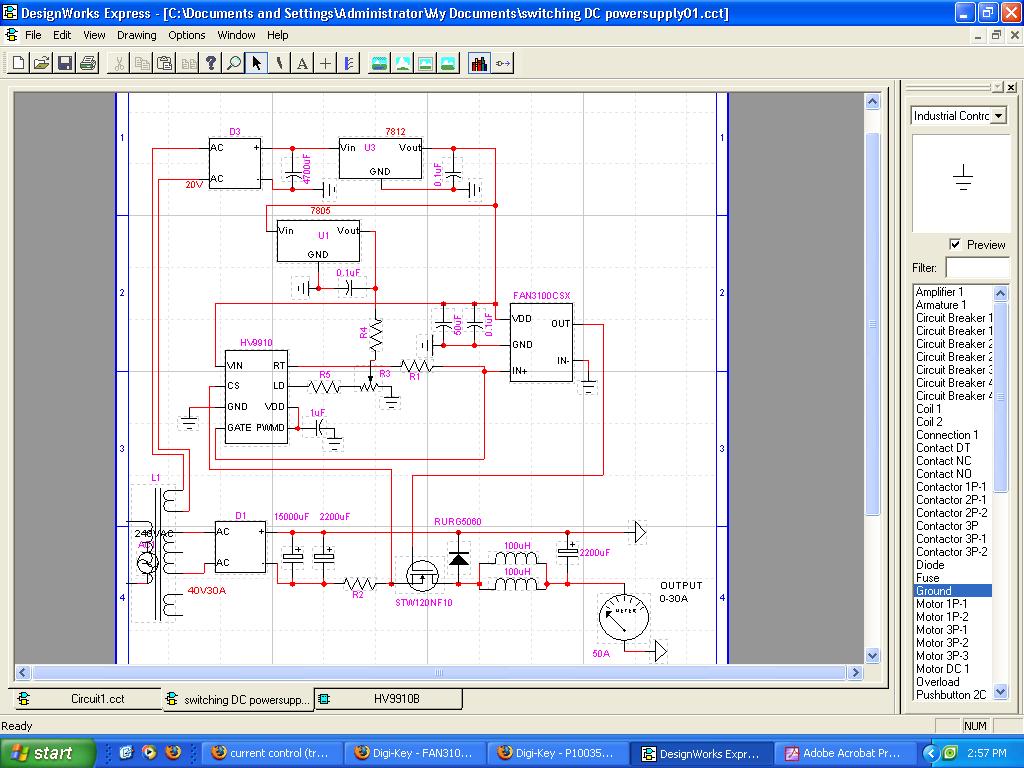

Revision 2:)
Unsure how to calculate values of R1 and R2. Theres some real heavy (complex) looking formulas in the data sheets!! Should the -output be tied into the gnd of the rest of the circuit for a feedback loop to the HV990 ?
I really appreciate all this help!!!!!
