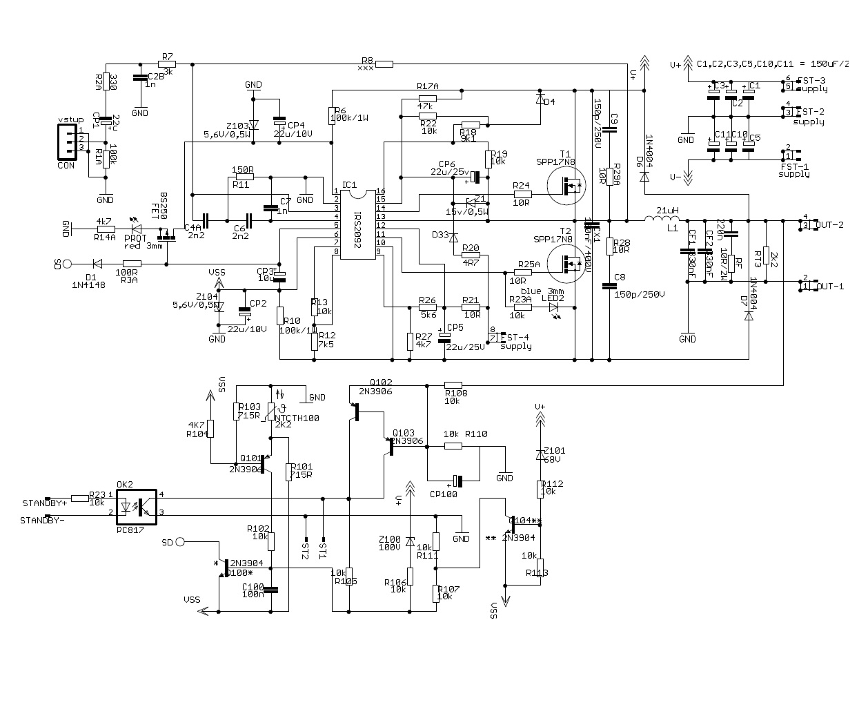

Let me post a similar application schemetic where user wanted to do some thing !

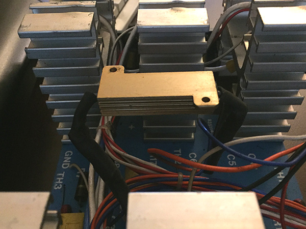

This application is for 400W ( forget my application right at this moment) , user said " I have connected additional parallel resistors to R117A, R118A, R17A, because amp was clipping, when power supply was circa 2x35V, is possible that leads of that resistors was to long?"
Now lets see other ( attached 2)
The main part of this protection circuit is a transistor FET which is connected in the power supply branch amplifier integrated circuit IRS2092. When applying a positive voltage to the control electrode of the transistor, the ground power supply voltage and the comparator halts the modulation process. The transistor FET is switched on the circuit that brings together a number of protections. One of them is check the power supply, which detects whether the supply voltage is in the range of 68 to 100 volts. If this the condition is not met, the class d protection will react. Additional protection is temperature. Circuit controls the voltage on the thermistor, which is located on the heatsink of the power switching Mosfet. Last class d amplifier protection detects the amplified audio signal at the output of the amplifier and responds when congestion or limitation.
Whats in your mind to apply this kind of circuit?

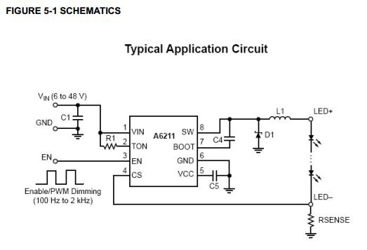

Current sense resistor in series with the load, in a small circuit rated at a few watts:

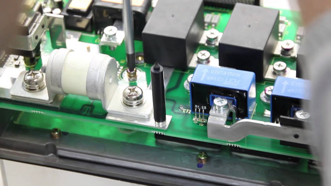

The current feedback sense resistor in a servo drive we have on the bench at the moment (in the 5 - 10KW range), which is connected directly in series with the load:
The blue item in this photo are the current transducers use for feedback in a rather larger servo drive (possibly 50 - 100KW), again in the current path to the load:
Those are all variations of switched mode or PWM power systems, which could be called Class D if intended for audio.
My company has been installing and repairing such equipment for several decades and I have an extremely good understand of how such power control systems operate.

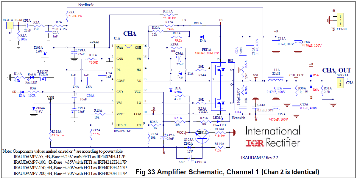

The two Mosfet class-D 400W audio amplifiers you showed have no control of the output current. If the current becomes too high then they overheat or the amplifier and/or the power supply become destroyed.

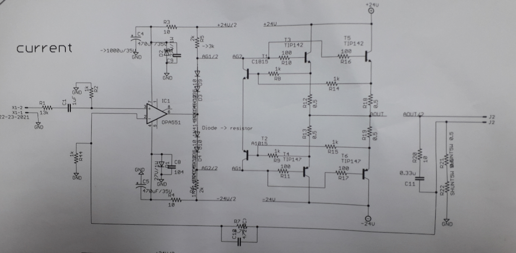

Now take a look my ClassAB which is used for current AMP, it has shunt, it has feedback .....see how darlington works
