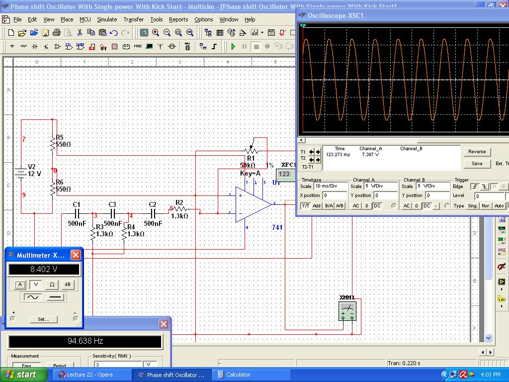

i am adding my Oscillator circuit.
And yes Eric, you are right.The load is a motor.which require 2.4A. i am thinking that i must amplifier to 3A.

I would ask the same as Bychon, looks like an 'ac' motor drive.??
If the answer is yes, then you will most likely need a push/pull FET drive.
The resistive split 12V supply will give you problems at 2.4A if you try to reference the FETs to the virtual 0V.

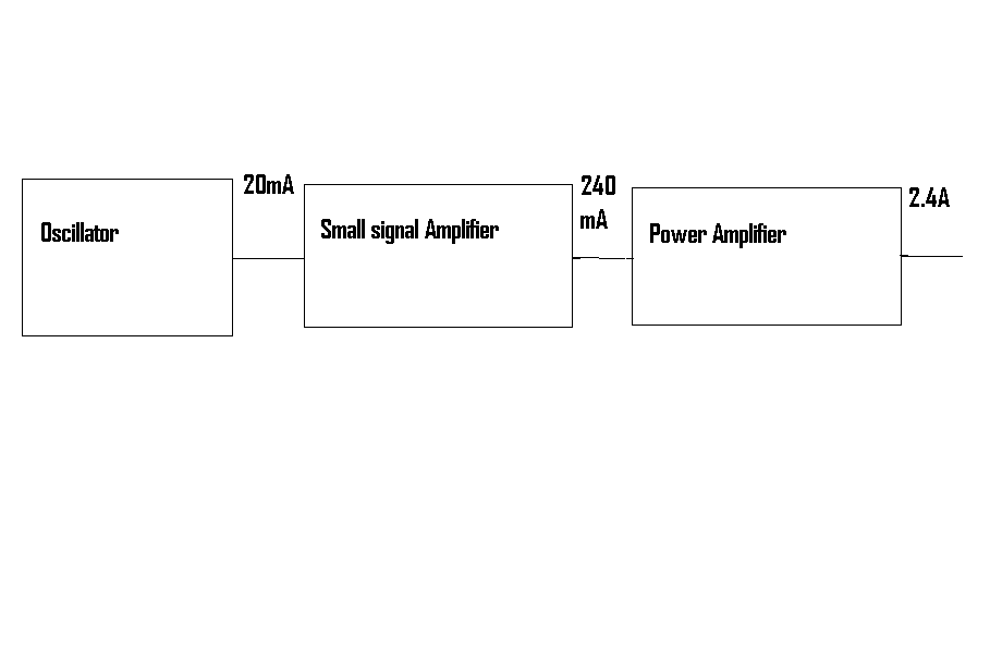

OK. i got the idea that how drive this power Amplifier. and i think it is very easy. look at the attachment what i am think is correct?
What you're doing will work but it won't be very efficient.
Is 165V the RMS voltage or is it the peak?
The typical class AB amplifier required will be typically only 50% efficient meaning half the power is wasted as heat.
A more efficient method is to use a class D amplifier which is >80% efficient but much more complicated.

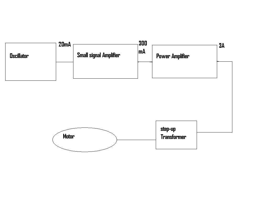

No. it's a 12v battery.
I am attaching the block diagram, what i was thinking that i would design my circuit in this manner. but you people are saying that this is not very efficient so i'll change my idea according to yours.
