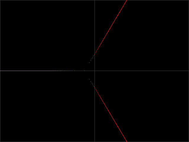

As a quick example i've included a root locus plot of a feedback system where we want to know if the system breaks into oscillation, and if so, what conditions cause this behavior. The plot is for a simple third order system and the red lines indicate where the system oscillates. Normally the x and y axis would be marked, but here each point represents one new value of K, a system parameter, where that one lone dot toward the middle represents K=0, and each successive dot moving to the right represents K=1, K=2, K=3, etc. We can see that when K=8 the circuit becomes a perfect oscillator because it crosses the imaginary axis, and because of the unique relationship between this frequency representation and the time domain representation we can also tell that when K is greater than 8 the circuit oscillates with more and more amplitude until in real life it would saturate the system and render the whole system uncontrollable.
The transformation of the circuit from the time domain to the frequency domain makes this kind of relatively simple analysis possible which gives us a very quick view of the system stability.
