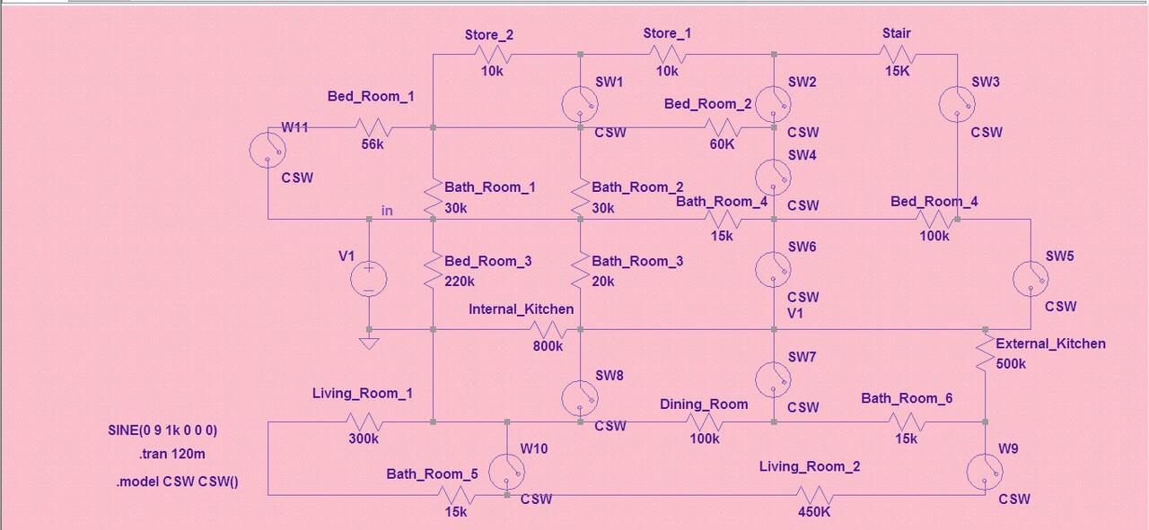

Are all the resistors in my circuit in parallel ?if not ? Could someone tell me which resister arenot in parralel? Since i want all the resisters to be in parallel
No, they're nothing like all in parallel. For starters you have most of them separated by switches. The arrangement in the post #6 link is (apart from the CSW) a parallel one. And why are you using current-controlled switches?
I put the switches because i want to show what is the differences between the measured power when the switch is open and when the switch is closed but i didnot found aswitch that i can open it and close it during the simulation is there anyone ?
Could you please name for me the resisters which are not in parrell to remove them so i can get acircuit that contains only resisters that are parallel
Not in parallel with what? LR1 and BR5 are examples of two resistors in series.
Instead of CSW, you can use the standard voltage-controlled switch. You will also need a voltage-source to control it, and a .MODEL statement for it. Check the Help ;).
Why don't you start with a simpler simulation until you have learned the basics?
