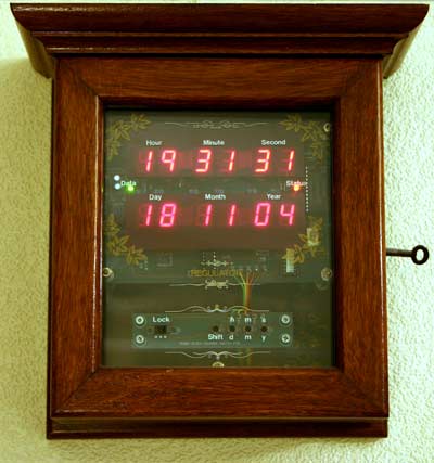

I have just finished making a Quartz crystal clock pulse generator for one of my clocks using a 32k Hz crystal.
It has just run for the last 3 days and has not lost or gained even a fraction of a second.
I set it up using a my old Maplin "Atomic" clock I made years back. This clock resyncs itself with an Atomic clock via radio every 60 seconds so is always correct. You can can get "Atomic" or Radio clocks for a few pounds now from Maplin/Argos etc. You can of course use "TIM" on your telephone.
All I do is sync the new clock with my ref clock then wait a day and recheck. I note how many seconds the clock is out then adjust the trimmer. Wait another day check and retrim again. Once you have got the clock running OK for a day just increase the time to 2 days or even a week. Don't forget by this time the adjustments on the trimmer will be very small indeed so I don't think with a 32K crystal this would be possible. The clock will also tend to drift summer and winter without temp. compensation so in the end you have to settle with a happy medium.
The setup takes a few days but in my opinion is the best.
