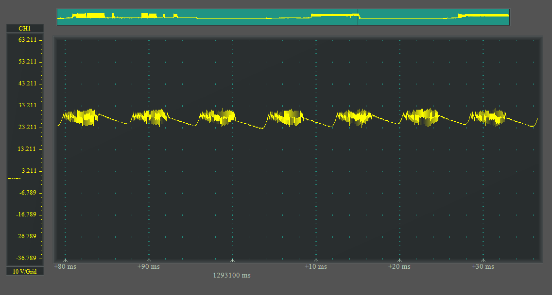

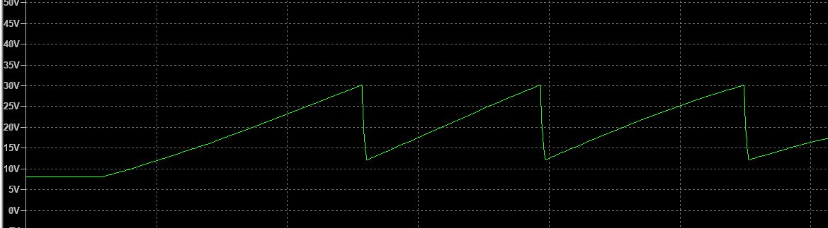

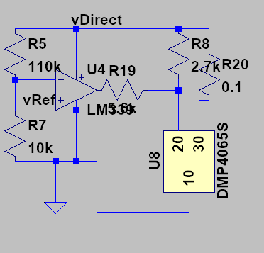

I'm applying a crowbar using a FET. The idea is to "push" the voltage back to the source rather than "burn" it off with resistance. The circuit below simulates and works correctly however there's no hysteresis to prevent the FET rapidly cycling (so in effect it is "burning" the voltage as resistance during the switch state).
Slowing it down using a small capacitor across R7 works to some extent but makes the crowbar voltage level frequency dependent. It currently turns on at 30V and turns off at 30V and therein lies the problem - it's relying on the op-amp and FET switch speed. I need it to turn off at say 10V, a 20V drop (anything higher than 8.5V as there's minimal capacitance after that). You can see as it stands the LM393 and FET on/off time results in a 8V drop. The TO-220 is getting HOT!
Any ideas? I suppose I could solve it using another op-amp but I'm now space critical on the design!

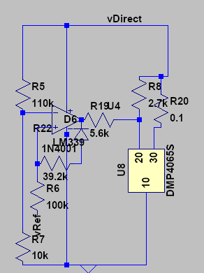

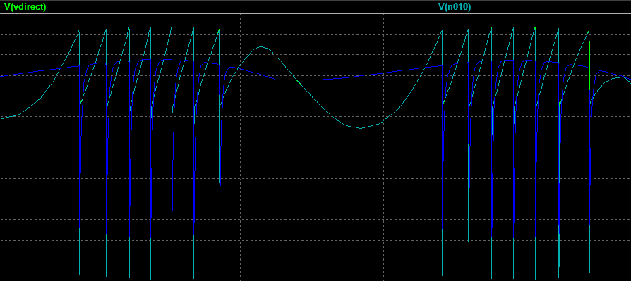

Played around and sorted it!

Yes.
Adding hysteresis by positive feedback around the comparator is the right way to fix this problem.

I'm not collapsing the power supply completely, there's a bank of super-caps and if it goes below the 10V mark they'll turn on and short through the FET. Then it will get _hot_.
I've modelled the supply in spice and it's performing quite like the real thing, circa 20% error. A data logger allows me to view the real thing and since it's low frequency the LM339 / FET is able to turn on/off fast enough.
Hysteresis is a good idea.
If you still have issues consideration could be made around R5 & R7, when the fet turns on & draws current, voltage going in to the top of R5 & R7 will probably drop causing oscillation.
If its an Smps can you 'fiddle' with the feedback & reduce the pulse width by sensing current with an op amp.
It's supposed to drop, there's always going to be some measure of oscillation (so some measure of heat build up). The approach is to make it voltage/frequency dependant not Op-amp/FET switch-speed dependant. If it proves successful switching should be about 1/5 (so says LTSpice, I have yet another PCB prototype on the way to verify it).
It's a highly inductive source with a high impedance (about 3 ohm). I have to be careful though if the voltage drops too much the super-caps will engage and at that point there'll be a fire!
