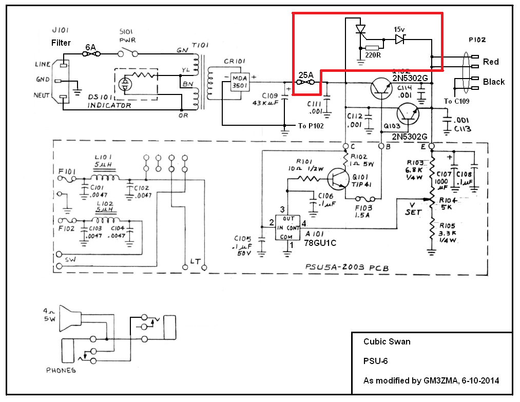

I decided to use a fuse + zener for over-voltage protection, in the case of a regulator failing s/c or other steady-state ov.
Is a zener the best choice for this? Or should I be looking at a TVS?
The standard crowbar circuit has always been a zener and a thyristor, just a zener on it's own would tend to fail S/C - and is a common occurrence where just zeners are used (and are intended to fail in that way).
Have a look at this:
A high current (20A 12v) PSU which if the regulator failed, could apply about 20v to an expensive HF radio.
The crowbar modification is highlighted in red.
That's a good idea, I might do that. Would mean I could use a polyfuse like I wanted to and not a wire one (not enough volts to trip the polyfuse, with zener option).
So, TVS not worth bothering with at all for this, then?
Probably not.
With the zener and thyristor, the trip point is well defined, when the thyristor is turned on it creates a short circuit and blows the fuse.
When the fault is clear and the fuse replaced (or cooled in the case of a polyfuse), the whole thing is ready to go again.

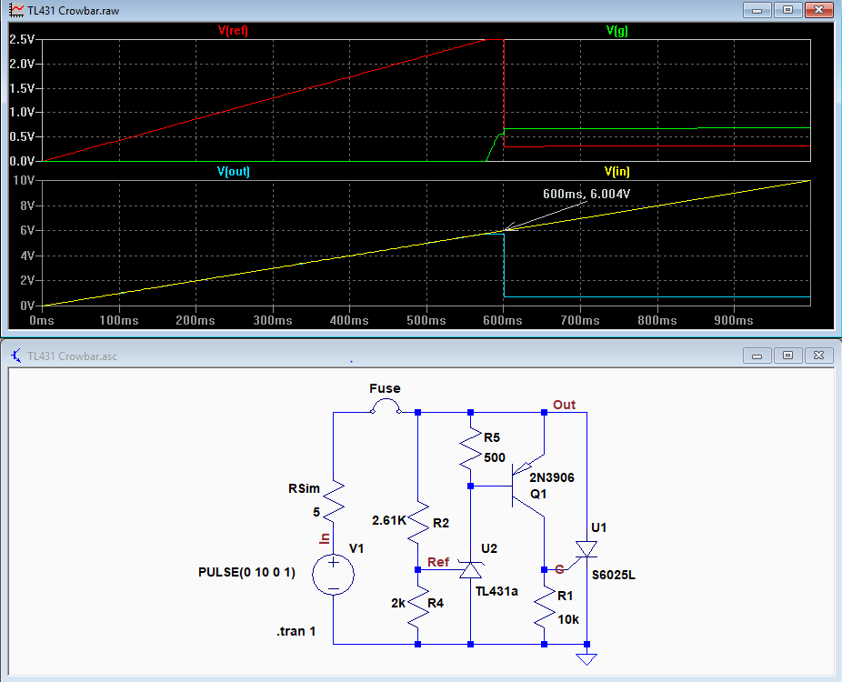

Here's the LTspice simulation of a slightly more complicated SCR crowbar circuit that uses a programmable TL431 reference as a comparator, if you want a more stable, accurate, and adjustable trip point than a Zener gives.
You adjust the R2/R4 resistive divider to give a REF voltage of 2.5V at the desired trip point (adjusted for a 6V trip in the simulation).

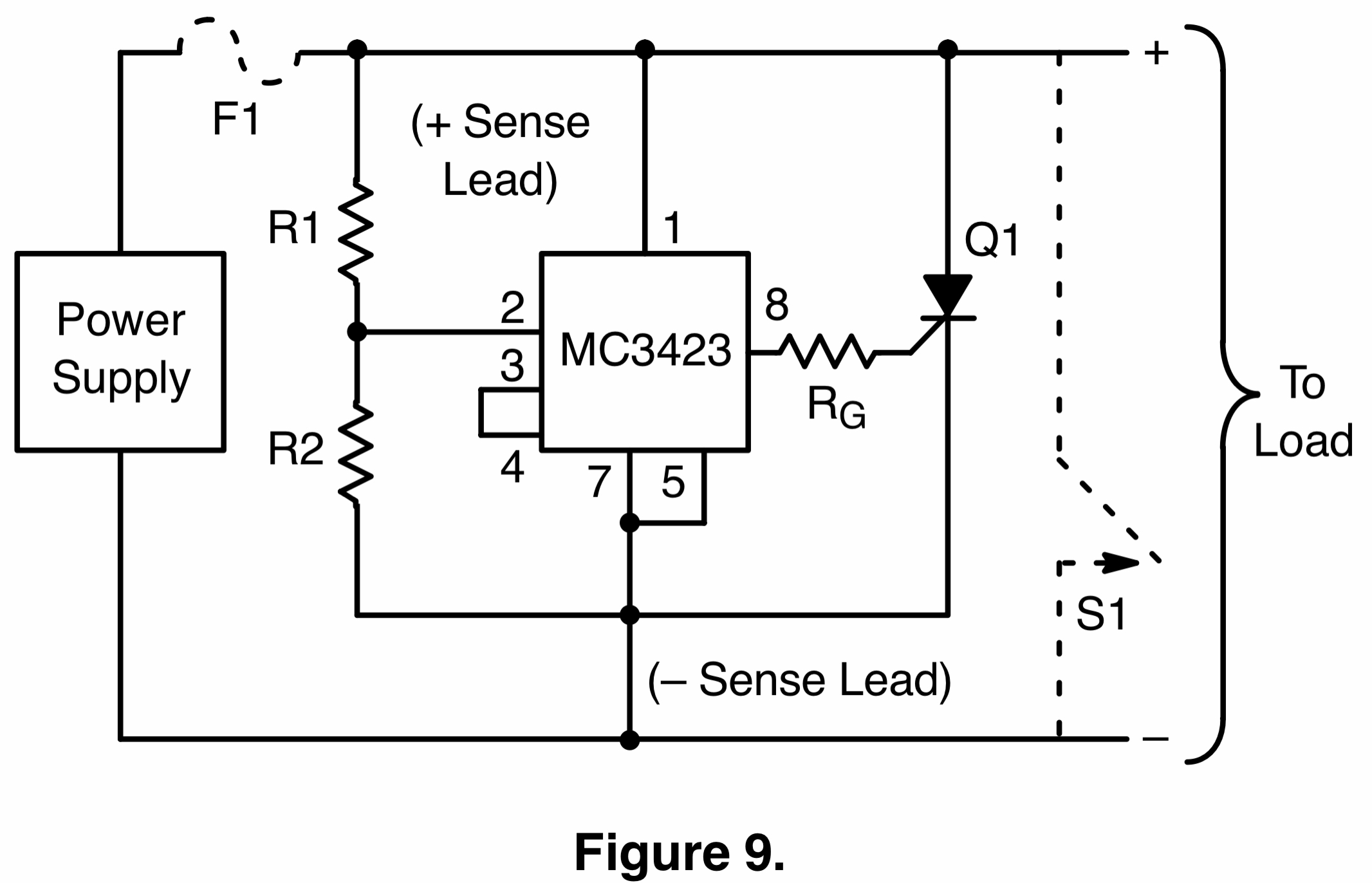

Motorola (ON Semiconductor) used to make a programmable crowbar tripping IC. Two resistors for the programming and an SCR for the short circuit tripper. If you need a few, let me know. I'm not sure they are still available.
