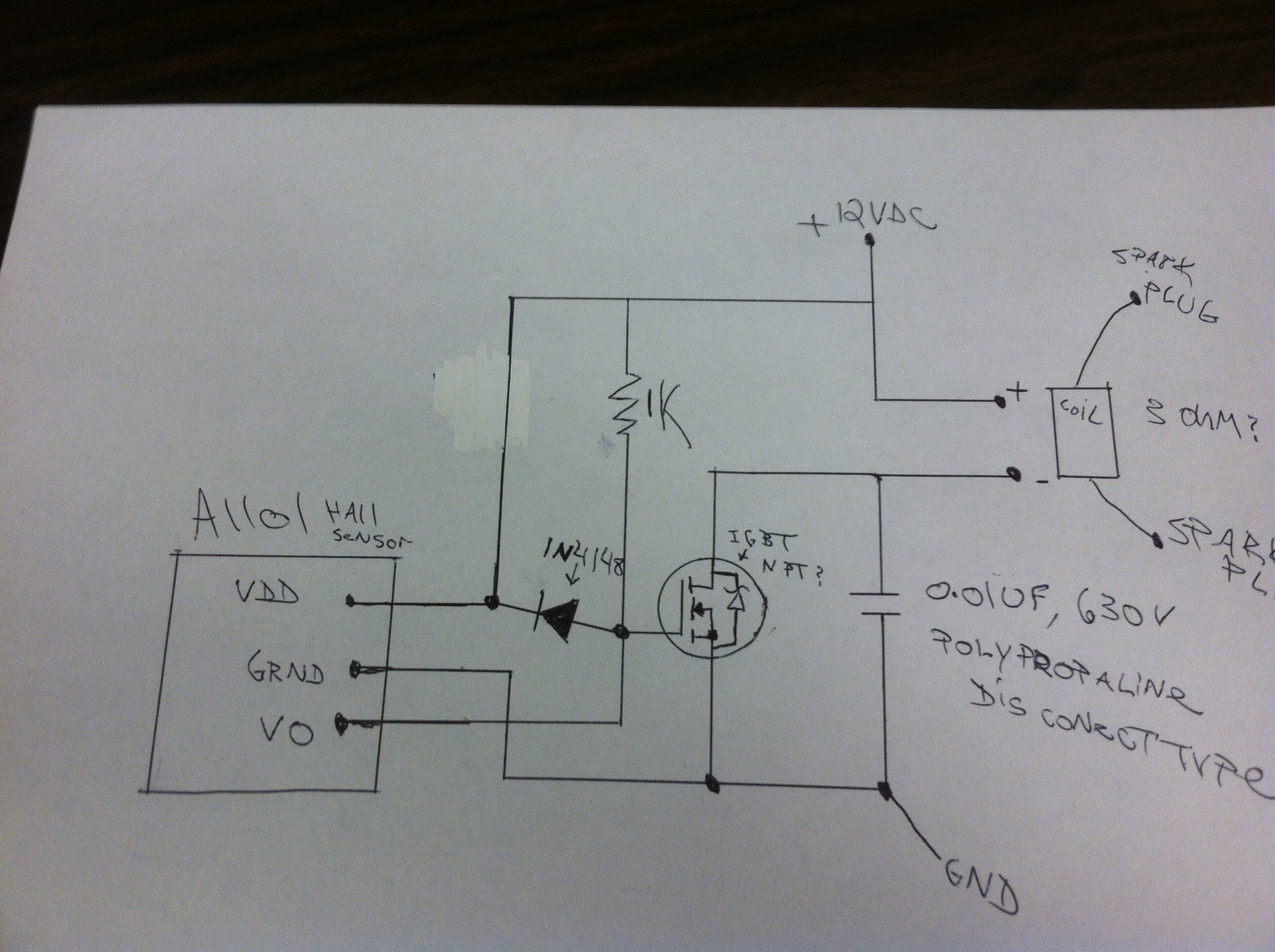

Ok so I'm trying to design my own hall effect ignition system for my 6 cylinder Datsun engine. What I'm attempting is making 3 hall pickup circuits that will trigger 3 single fire dual lead coils, just like a motorcycle but for 6 cylinders. Trigger A will fire coil 1 for cylinders 1 & 6, trigger B will fire coil 2 for cylinders 2 & 5, and trigger C will fire coil 3 for cylinders 3 & 4. This would be considered a wasted spark ignition. The hall pickup units will be separated by 120 degrees in circumference, for 360 degrees total.
I have designed my own hall effect circuit, however I don't think it is correct. I could use some input.

How are you going to advance the timing?
If you are going to use a distributor, then it is a waste to use three coils.
It would be easier to use one sensor, and a PIC or ATMEGA to fire the coils, and to add the correct advance for the RPM and throttle opening.
You could also get a used ECU from the scrap yard, and the coils and sensors, all from a similar engine, and maybe even have that re-programmed to precisely match your engine and driving needs.
You could also look at Megasquirt, you can use it just for ignition or complete management, often available on fleabay for an OK price.
It may well be simple to make the engine run, but to make it rum properly is not going to be a 5 minute job.

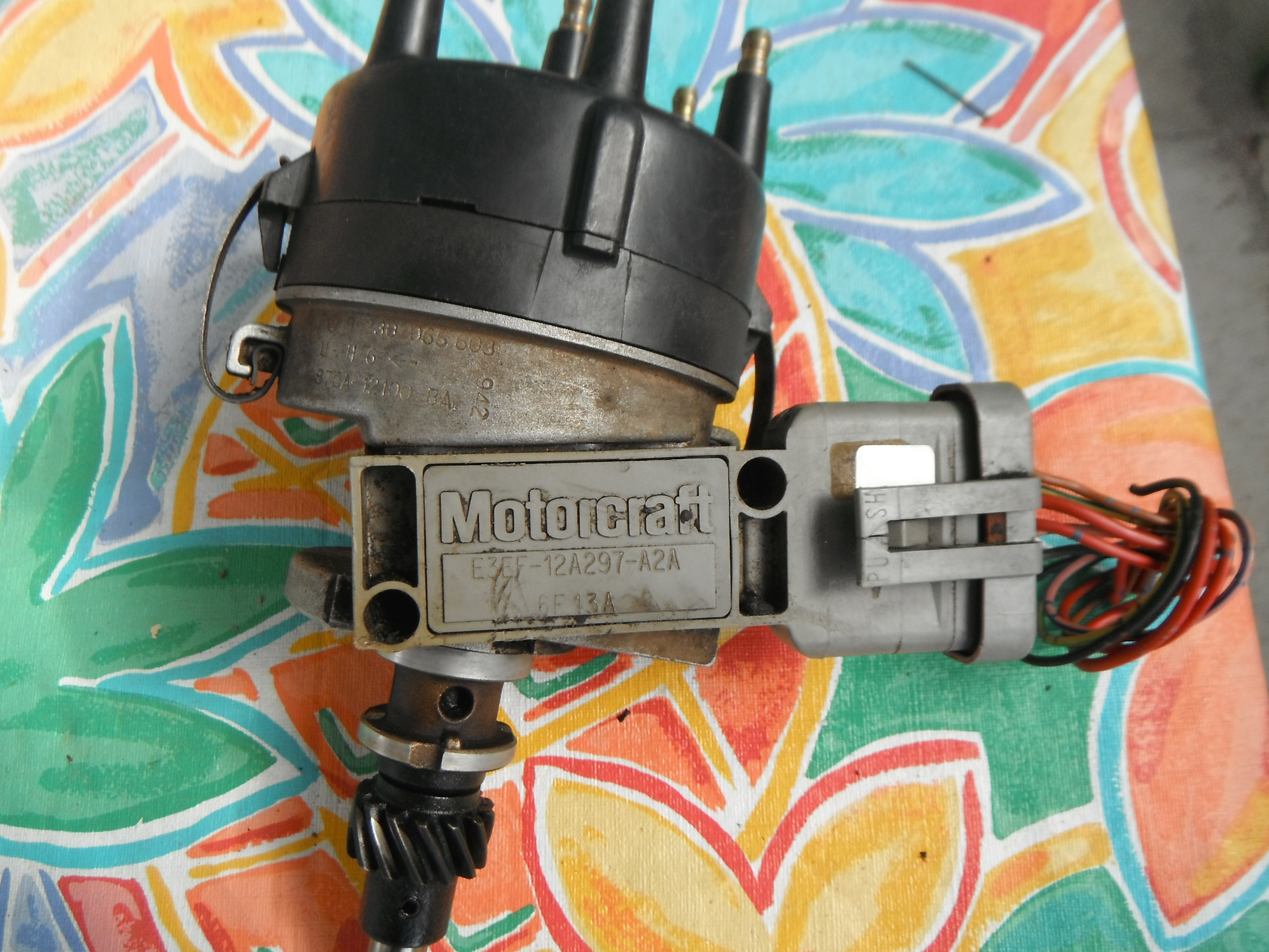

Just thaught id throw this in for interst. Its a Ford 6cyl electronic distributer usung a Hall sensor. Maybe you could modify your dist with a Hall sensor & metal chopper disc & still use your advance system already on the dist.

Yup this is where I was going :eek: however I have not seen this unit in the U.S. Funny thing it seems that you down under get some interesting automotive tech, especially when it comes to Nissan/Datsun!

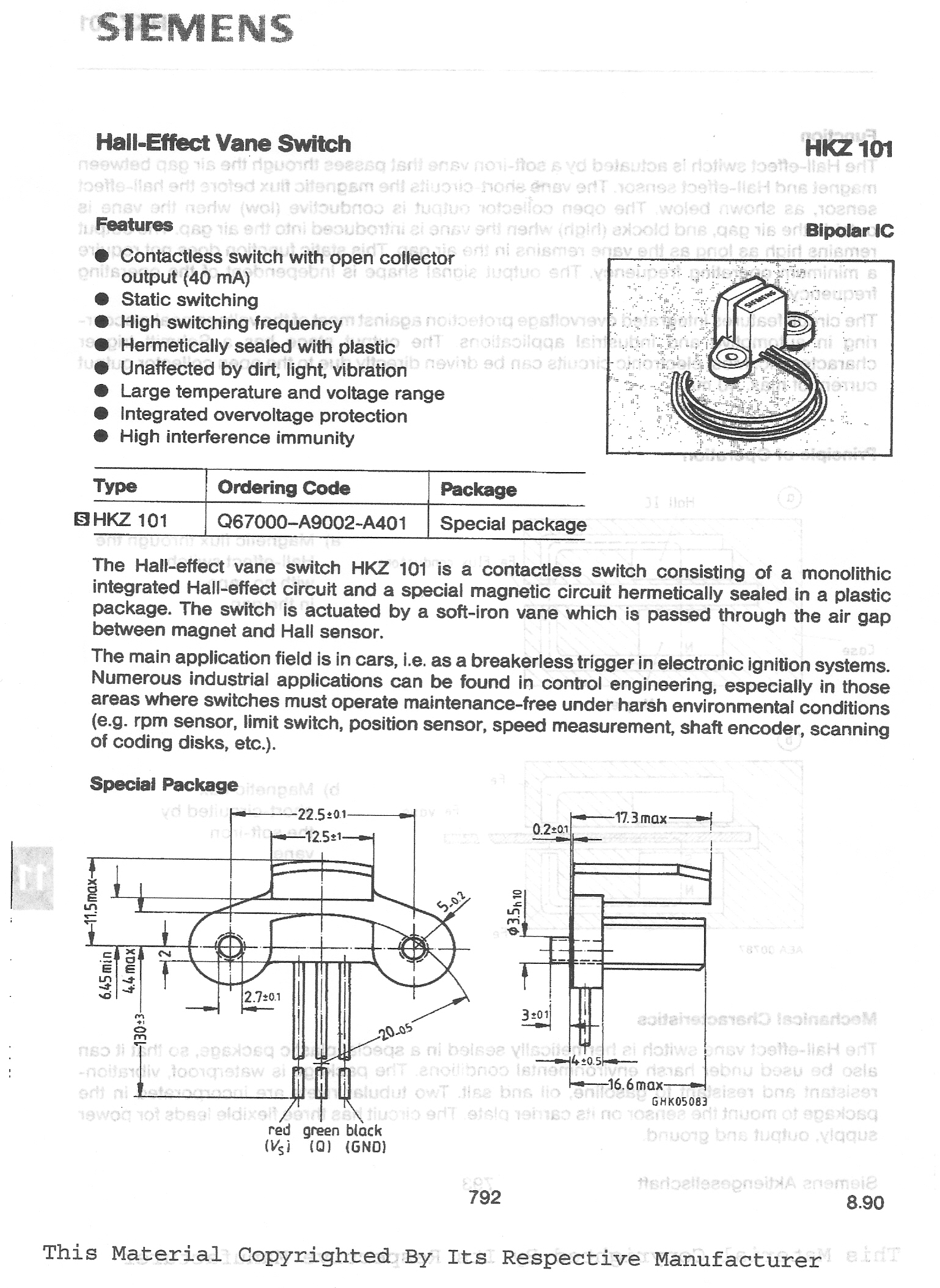

This is the Hall device in that Dist, about $20 here.

I admire your intentions, but can't help feeling that incorrect timing could well end up costing you more than a commercial ignition system.
The MSD6530 looks like it would do a good job, and I'm sure you would find someone to suggest a starting point for the advance curve.
I was basing my comments on the diagram you gave on your first post, which had no control over the timing.

Thanks for the input. Sometimes I forget to give better explinations with my ideas. You are correct that my original design does not add a spark curve.
