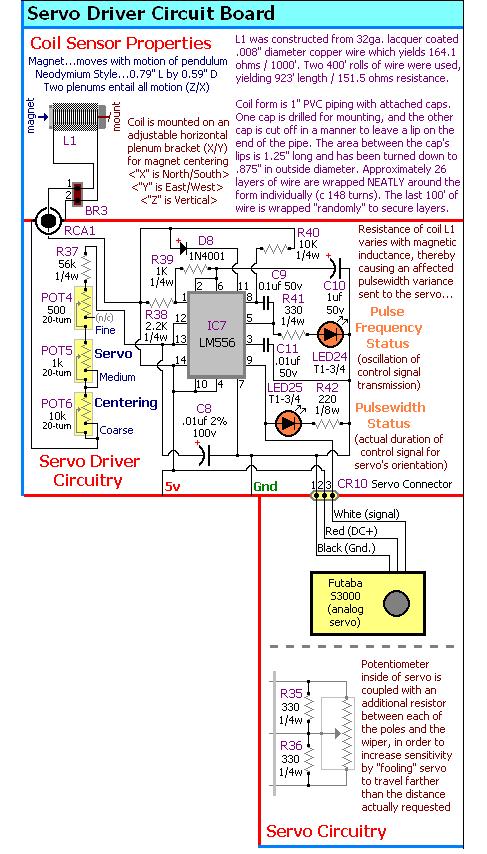

Creating An Activity Meter From A Pulse Width
It's the output pin (9) of the 556, which I believed generated
the pulse width (on that side of my board I have three pots
for centering the servo, and on the other side of the timer I
have the servo connection), but it doesn't make sense to me
that the servo is only getting that small of a voltage signal
to drive it. The side of the timer that has the servo connected
to it (I believe) generates the refresh (48Hz), but according to
my schematic attached in my first post (which lists two 555s),
that would make it backwards on my circuit board. I do get
the refresh signal on that side of the timer though. Soo, I'm
guessing it really is the PW generator side of the circuit that
is putting out that mv signal. Either way, when I make the
magnet stay still in the coil, that V signal stays extremely
constant, fluctuating up to 0.1mv, which in a scale of 1.0mv,
would be acceptable. So, I would bet the signal (where it is
I'm getting it at), is VERY stable. The other output pin (where
I get the oscillating signal), has a much higher V output, also.
But again, the signal I'm getting, from whatever part of the
circuit it is, changes with servo motion, remains stable, and
does not adversely affect the servo's operation when a draw
from my meter is applied.

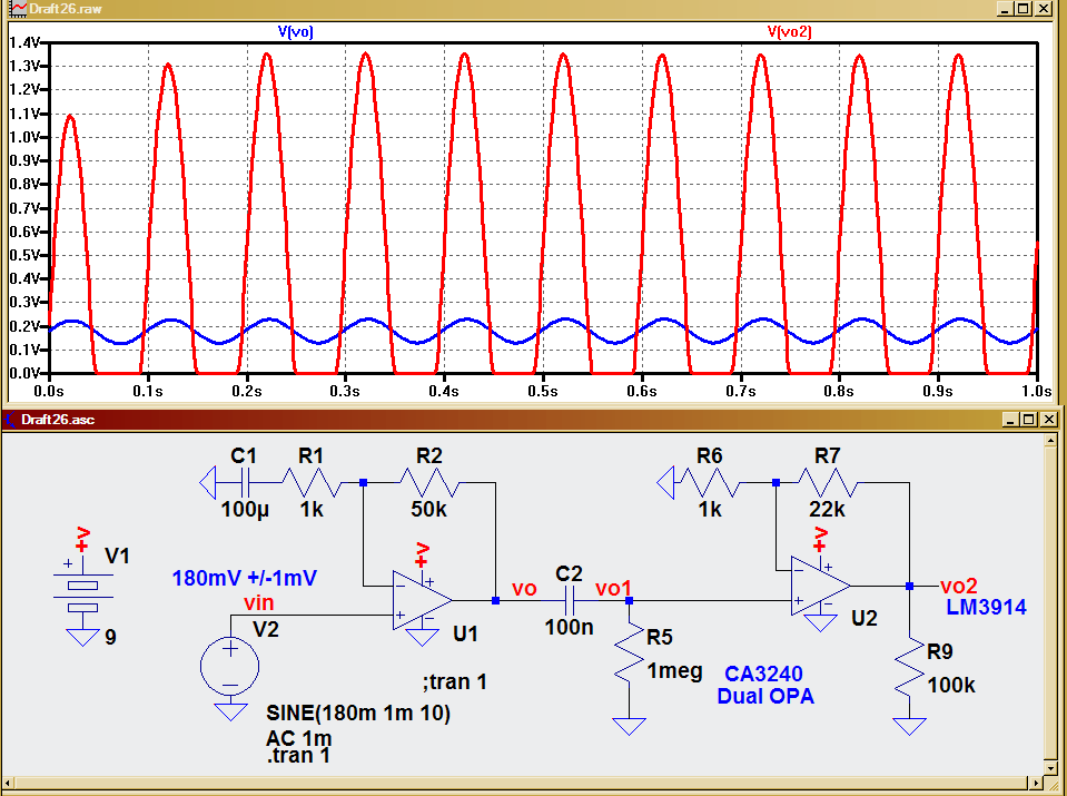

The attached image is the way it could be done, this way the amp is 'ac' coupled so a slow drift on the 180mV will not be a problem. I have not finalised the design at this time, I plan to to do a hardware version check.
I am assuming the 'tremor' frequency will be higher than 1 cycle per second.?
I think we will have a problem using the output of the 556.??

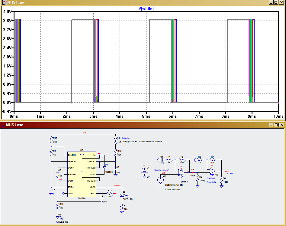

Simulated your circuit using LTspice, regarding the 180mV +/- 1mV measured on pin 9 of the 556, how did you measure the signal.
If you used an ordinary voltmeter that would explain the reading you saw.
The servo expects a changing mark/space ratio, usually its a 20mSec frame rate with a ~2mS m/s deviation.
Look at the simulation plot and you will see this deviation, I have had to use a massive inductor value in order to get a reasonable plot.
Based on this test I would say the method for displaying the difference in servo feed signal is a non starter.
Ignore the right side circuit on the image.
The LM3914 circuit that we discussed is working on the bench with a simulated 180mV +/- 1mV signal... this is of course not usable with the 556.
Let me know what you decide.:)

I am saying that the +180mV +/-1mV is not usable in the way we talked about.
The 180mV read by your DVM is not a steady DC signal with the +/-1mV sitting on top.
As you know you the DVM is reading the average value of the servo drive square wave.
Regarding the 'bench' test, if you recall yesterday I said I had a circuit in simulation but I wanted to test the actual circuit by building it, which I did and it runs OK.
But thats with a steady 180mV DC signal and +/-1mV on top, which of course isn't what we are getting from the output from the 556 to the servo, so we can't go that route.
Using a pair of 555's to replace the 556 is not a problem.
Can you measure the voltage signal across the coil when the pendulum is moving as expected.??
It may be possible to pick off that signal, amplify it and drive the LM3914 that way.
You will need a scope to get true coil voltage.

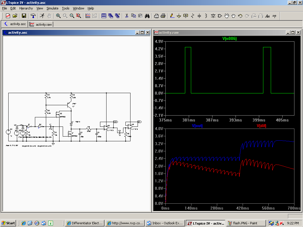

Eric,
Here is a circuit I have used to convert pulse to voltage. Is it what you are looking for?

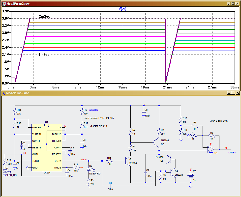

hi Ron,
This is a version that would do the job.
I have edited the 556 timer to a 20mS frame and a mark of 1mS to 2mS to suit a standard servo..

hi Ron,

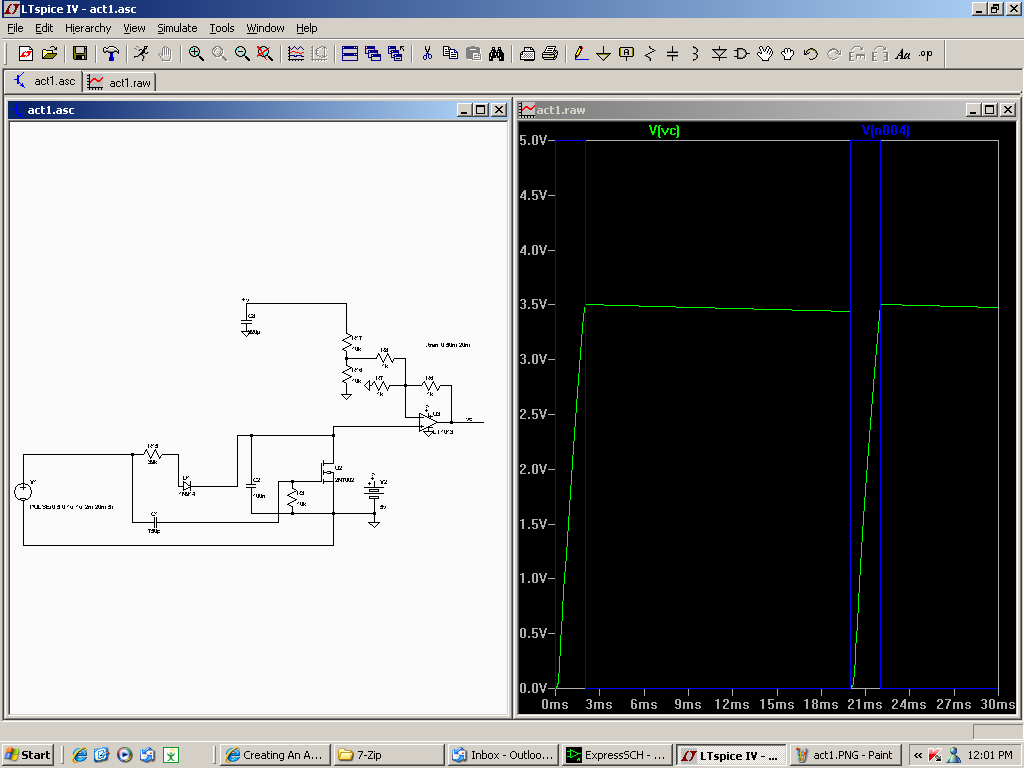

As you can see I haven't figured out how to plug your 556 into LTSpice yet, but here is another cost reduction since it is really only a visual indicator and not a servo. I'm still trying to figure out if he wants it to return to zero (AC coupled) and just show a change. How do you read it?

I read it a couple more times. Seems like this is the right approach. See if we agree on the following:
1-The signal will always be AC it can't go to 2 ms and stay there. Therefore AC coupling so the LEDS return to center is not required.
2-If you had 2 sets of LEDS with 1.5 MS at the center you could make the LM3914's so that under vibration they would both appear to light more LEDS in both directions.
3-The earth can't shake at over 50HZ.
After babbling it seems like you have it. What do you think?

If you look at post #24 circuit that the OP is using, I am not satisfied with some of the component values/timings also the description on how the circuit works.
What do you think.?
