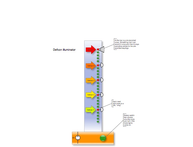

I would like to create a small gadget for my desk in work? However, I have no idea where to start. Running from some batteries, I want a some leds to light up the more I turn a dial and then every fifth led I want a bell to ring. on the final led I want a pre-recorded sound to play. Ideally I would like each led to light up on its own.
I have no idea what components I will need or if this is even possible, I have a picture in my head as to what it should look like, attached. Can anyone point me in the right direction.

Welcome to this forum. First you are going to either need a microprocessor and then get it programed, or use some integrated circuit counters. I can easily help you design the circuit with integrated circuits. There are members of this forum that are good at doing a project like this with microprocessors. I can guide you through with IC's. Your location will be a great help to anyone.
One reasonably easy approach would be to cascade three LM3914's; you'd only need 2 & 1/2 of them, but that and a pot would pretty much take care of the 25 progressive LEDs.

It depends on your definition of easy. An LM3914 would most likely be quicker to build and for someone with little to know electronics knowlege, this is the one that I would recomend. The catch is that it will be tricky to get the alarm to sound at the specific LED and the prerecorded message is another signifigant challange. The microprocessor or microcontroller could be quicker to build with the external components but would take longer to program. If you have someone helping you with the process you can try to go with the microcontroller. It would be easier to have the microcontroller sound on the LEDs since it would be the one in control, and it would be signifigantly easier to have it play the prerecorded sound since most audio recording chips opperate off of the 5V logic range. If it is a more simple sound, the microcontroller itself would be able to play the sound.

The cost depends upon a number of factors. Such as component count, labor,shipping costs. Yes as sgtwook said LM3914's would work. As dragon tamer mentioned if may be tricky to get the alarm to sound at the right LED. If a opto coupler is connected in series with the appropiate LED that would solve the alarm sounding problem.
I think I could do it with 3ea CD4017 counters,a nand gate clock and a ISD recorder chip for the sound.

...and with LM3914s it would be easy to add some OR logic to play a sound when LED 5,10,15...is on.
For a cheap sound generator would the innards of a musical birthday card do? (provided, of course, you can tolerate repeated playing of the same jingle!). Or small buzzers are available cheaply.

You just use diodes on the outputs of the LM3914 chips where you what the beeper to work.
how much power/ volts will I need
If you use a 9 volt supply your voltage divider for the pot and chips would have 3 volts per chip and .3 volts per LED.
