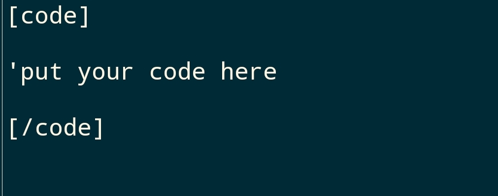

Yes. Please learn to use code tags. Type exactly the following:

There used to be a function called [noparse] that would allow you to post tags without them being interpreted. Has it been completely removed or replaced with something else?

1 Please read post # 2 carefully. Visitor gave really good advice and you seem to have ignored or misunderstood it

code tags - ignore
Congratulations on finally using code tags properly. Everyone who looks at your posts appreciates it.
I followed visitors advice in post 2 but it didn't display correctly?
