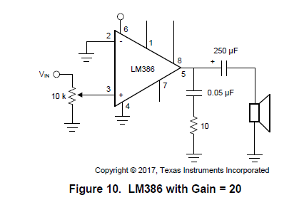

Ok, so I created a standard amplifier circuit with an LM386 except that I used a pot in the gain section in an attempt to reduce distortion but that only helped to a degree but not enough. I even tried reducing the audio input capacitor from 10uF to 1uF and that didn't work.
So now I think my problem is the input is too high. I'm using 7.2V into the +ve supply of the amp, and with the ISD1700 chipcorder as input I have a choice of 7 different volume levels each 4db apart in volume.
How do I convert this db value to a peak-to-peak value so I can adjust the LM386 accordingly? Would I be forced to use the lowest volume (at 4db i think)? or do I go higher?
The minimum gain of a LM386 is 20, so to get ~4Vp-p across the speaker, the input level only needs to be 4/20 = 200mVp-p. You will likely need an attenuator between your input device and the LM386, like this (taken from the data sheet):

Pure resistance in the audio path has no impact on audio quality. A potentiometer (like Mike shows in post 2) or a pair of resistors set up as a voltage divider, will attenuate the audio level, but won't distort it.

So I did more experimenting and removed the 470-770K resistor from VCC to +ve input but I still left in the 10K to ground, so in effect, I'm using the standard attenuator setup with volume set to max.
My input capacitor is 10uF electrolytic. should I lower this value a bit? I'm afraid if I lower it too much then not enough audio will get through.
Then I ran more tests and noted that if the volume level (on scale of 0 to 7) is below about 4 then I hear continuous oscillation even if in my gain circuitry (of a resistor and capacitor in series connected between pins 1 and 8) the resistor is 20K. If I make the volume level higher than 4, then I actually hear the music but somewhat distorted, but it was better than before.
Could it be my output filter thats a bit messy? I'm using 4.7nF and 10 ohm resistor in series connected directly to the output of the opamp, but then doesn't this zobel network (I think thats the name of the filter) depend on the actual output device used? (speaker, earphone etc?)

You need to build it properly, randomly bodging things in the hope it will miraculously start working isn't going to happen. The LM386 circuit is posted above (yet again), use that, don't add extra bits on for no reason, and don't take parts out. If you don't want a physical pot, then replace the pot with two resistors, but use a pot first and measure the two values when you've adjusted it to where you want.
ok, there is one thing I somewhat did neglect. Now I just added a 1000uF capacitor almost right next to the op amp IC and things work much better.
I thought I already solved that issue with a 47uF capacitor on the PCB. I did use a 6 inch cable to connect the amp section to the rest of the circuit but that cable must have made it worse

A pot was added to the gain section of the LM386 in an attempt to reduce distortion? But the datasheet of the LM386 shows distortion very low at 0.2%.
An input capacitor value of 10μF was randomly selected to produce a cutoff at 0.32Hz instead of calculating 32Hz needs only 0.1μF.
A DC voltage was added to the (+) input of the LM386 with a DC voltage divider that guarantees distortion. Why?
Please post the schematic.
