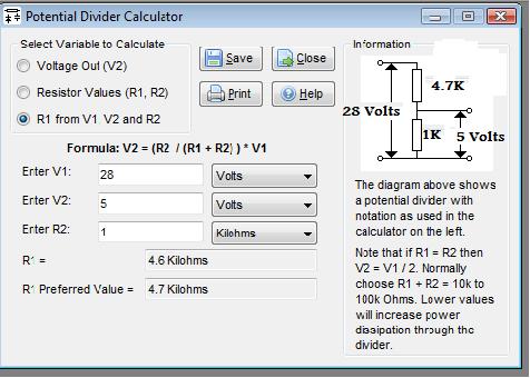

A resistor divider is probably the easiest
Not a good idea
Would these diodes tolerate 28v ?
Can cause a lot of bad things to happen.
What is this 28V coming from? Can you explain exactly what you're trying to do?
I have a system which I want to test.
Basically it should output 28v or 0v depending on it's input condition.
I thought of using a digital input pin instead of an ADC since I only care about the logic level.
Anyways, I'll just use a resistor divider.
Thanks.

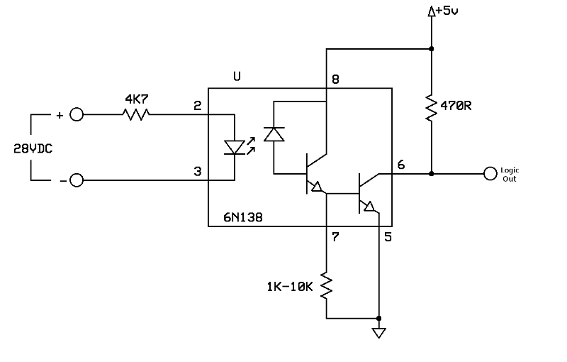

Rather than attempting to reduce the voltage at the source and have the source directly drive the logic circuitry, you can use something like a relay or even an optoisolator to do the trick for "indirect" drive of the logic circuitry if the 28V source is capable of driving a 10-15mA load. This, I think, would be a "cleaner" way of doing things as the uC circuitry will not affect the loading or operation of the 28V circuit that you're monitoring.
If you decide to go the optoisolator route I recommend the 6N138 or similar. The 6N138 will accept a relatively low input current, the emitting LED only requires a forward voltage drop of around 1.3V and is a fast switching device (rise time = <2uS).
Here's a schematic using a 6N138 optoisolator to do the job you're asking. The 4K7 resistor is sized for a forward current of roughly 5-6mA with a 1.3V drop across the emitter LED on a 28V source voltage -
opto1-jpeg.53693

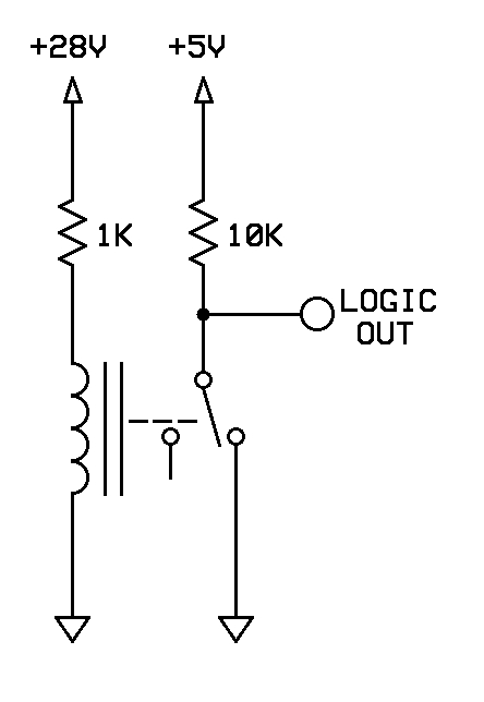

And here's a way to do it with a small signal relay. The 1K resistor is sized assuming a coil rating of 12V @ 15mA on a 28V source. The Omron G5V-2-H1-DC12 is a perfect match for this. Even though it's a DPDT relay, you would just use one of the internal switches in it -
relay1-jpeg.53695

The beauty of the optoisolator is that the driving circuit doesn't need to be referenced to the same reference as the uC circuit. It's basically current loop technology if you think about it.

Jon Wilders suggestions are perfectly fine, if incredibly expensive (comparatively), but you wouldn't even consider using them for such a trivial task - you use them when isolation is required, not a simple (and small) logic level shift.
Just FYI for the OP...my suggestions were by no means a "you must do it this way or else" suggestion. They were meant as a "here's another way you can do things" suggestion. Granted the relay method would be the most expensive of the two, although perhaps the simplest, while the optoisolator can be had for around USD0.80 vs a USD0.10 resistor and a USD0.05 zener diode. I was more concerned with circuit loading myself as the inputs will draw SOME small amount of current through the dropping resistor, which will further enhance the voltage drop and cause the loading issue. Although perhaps "trivial" or "miniscule", the suggestions I offered would have zero loading from the uC inputs provided the 28V source was capable of driving 5-15mA loads.

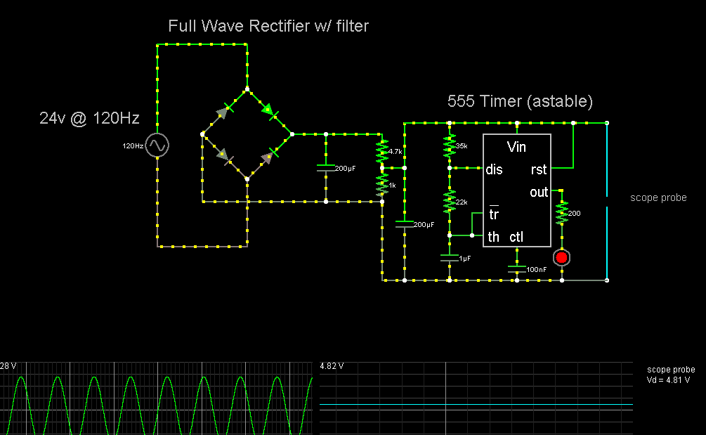

Just wondering guys:
I played in the falstad circuit simulator to see how I'd go about converting 28VAC to something the PIC could work with. I used an astable 555 in place of the PIC because that circuit sim doesn't have a PIC. Can someone look at this schematic and tell me if it's looks like it would do the job of taking the 28 VAC signal and converting it into a stable 5ish DC volts for the PIC to work from?
I know the guys was talking DC in the original post, but I've got something that has 28V AC that I'd like to monitor. Please see picture, attached.
The 555 resistors values were mostly just random.
Long story short I'd like to monitor an old thermostat for duty cycle of different components in the system (heat, a/c, etc). These things can be monitored by testing the voltage of the different terminals on the thermostat. I'd like to use a setup like this to create a stable power supply, and then several other setups to to the AC to DC conversion and then the DC level shifting so I can test the state of each pin on the thermostat and use that to increment counters and what not.
Will this type of hardware setup work?

That will work just find wannaBinventor
It 'may' work (I haven't bothered working out the current in the potential divider and that required by the 555), but it's a VERY, VERY poor way of doing it, and VERY, VERY inefficient as well. If I was an examiner marking a design like that, the student wouldn't get a pass :D
If he really wants to lower the supply to the 555, then use a regulator (a simple transistor, zener and resistor would be enough).
But a simple 47K resistor (as an example value), direct to the PIC pin from the 28V is all that's required.
