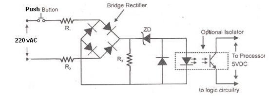

i searched about opto-coupler method and find the following circuit
how can i choose the value of R1,R2 and R3 values ? ZD value?
regards
A capacitor-fed power supply would be much simpler and much cooler.
100n in half-wave allows 3.5mA or 7mA in full wave so you can work out the value you need.

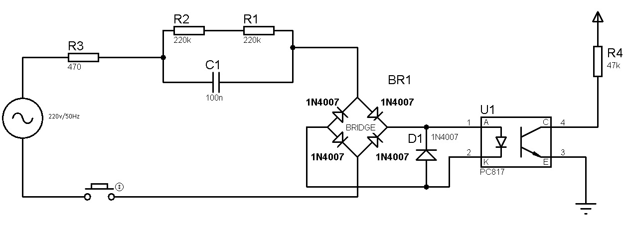

hi all,,
i found the following circuit using optocoupler
any modification ?
should i use protective elements ?
the power rating of the resistors ?
regards :)
C1 is the crucial component, it MUST be a special capacitor rated for this use - it must be X-rated.
R3 should probably be a fusible type, as it's there as a fuse - R1 and R2 are just to discharge the capacitor.
BTW, this circuit provides AC pulses on the output, not a DC voltage.

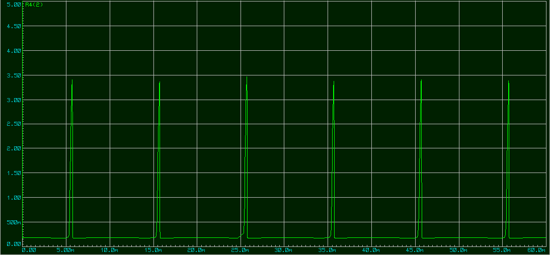

I simulate the circuit the output was 5v .
when the button pressed the output goes low and still low while button pressed..
Is there a problem in simulator ?
When I remove the bridge the output was AC pulses when the button pressed :)
Regards :)
I don't use simulators, but they often don't work as in real life.
There's no AC smoothing in that circuit, so the output will be a pulse not DC.
Did you have the simulator input as DC instead of AC?.
No .. it's a.c. input :)
What should I do to get DC output ?
How were you checking the output? A DMM will average the signal and show it as very close to 0V, whereas in fact it is a series of very brief 5VDC pulses (one pulse per half-cycle).
yes i used DMM and i check the output on the oscilloscope it was as you say..
