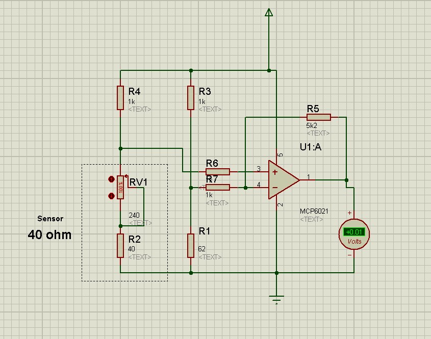

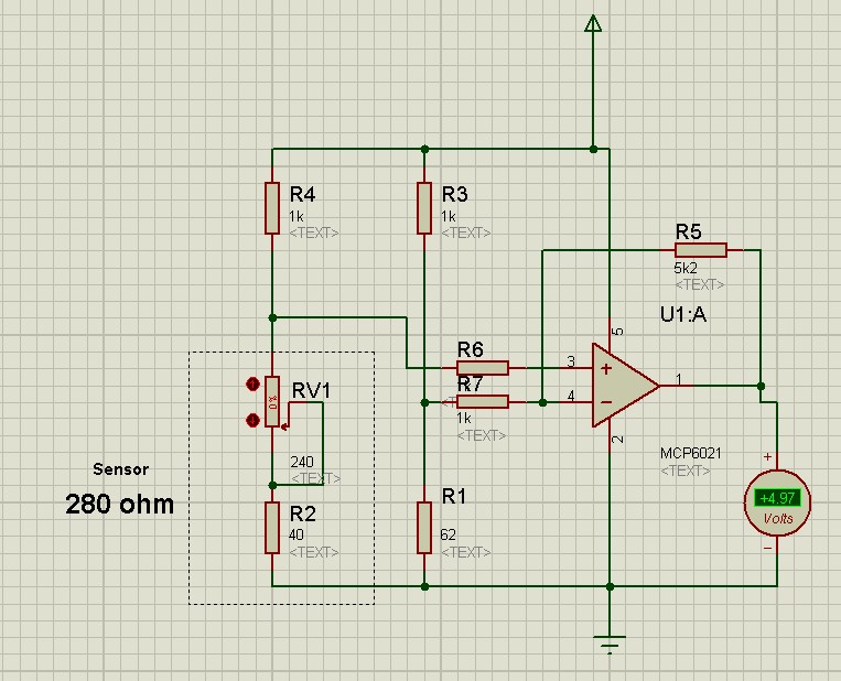

Hello forum. I have a resistive sensor, with output from 40ohm to 280ohm.
What i want to do is add some circuity to convert this output, to 0-5Volts. from what i can find, there is no way to do it using single-stage op-amp or just a resistor.. (best i can get is 1.5v to 4v) .so i suppose it will require a two stage op-amp or something...
can someone provide me with a circuit that will do this??
280 ohm output
40 ohm output

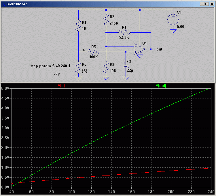

Modern Rail-to-rail OpAmp.
There is some combination of R1, R2 and R3 that perfectly fits the end points.
I included a slosh-filter (R5-C1).
Power supply filtering not shown...
Circuit is ratiometric with respect to the 5.00V source.
