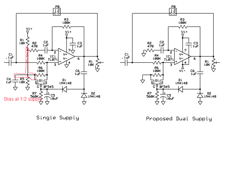

I would like to convert the single supply AGC circuit on the left, to a dual supply circuit. The right is my proposed circuit. I would appreciate your thoughts about the dual supply circuit.
I removed the R1,R5 voltage divider and grounded. I also added the negative supply.
Thank you
What you did with the op-amp looks good.
The J-FET has problems.
Old circuit: D=1/2VI+, S=1/2VI+, G=oV
New circuit; D=0V, S=0V, G=0V. Problem is there is zero volts G to S.
I don't know what VI+ is. Pretend 10 volts.

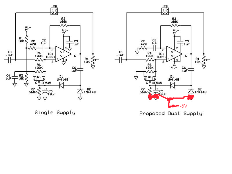

1) If VI+=10 and VI-=-10 then: Use R1, R5, C4 to make a -5V supply and connect the ground point (R7, C5, D2) to the new -5V. This way the G to S voltage will be 5 volts again. (you moved the D and S down 5V so move the G down 5V) or 1/2 supply.
2) If VI+(old) is twice VI+(new). VI+old=10V and VI+(new)=5V, VI-=5V.
Connect the ground point (R7, C5, D2) to the new -5V. (-supply)

If you look at the origional Single supply one, you will also see a connection from the Drain of the fet and R3 to the inverting input. It Allows for some Reduction of sound by subtracting from the origional waveform.
The area circled in red is the bias supply. It is 1/2 VI+. There should not be any audio at this point. This is no feed back there.

In my opinion, If it Were just a BIAS there would be No Reason for C2.
C2 Blocks DC bias to the IC, but allows AC Signals to go through.
The only way to know for sure would be to prototype it and check it with a scope.
The gain of the op-amp (with out the J-fet) is set by R3 & R2.
C2 reduces the gain to 1 at DC.
Swap C2 and R2. The function will be the same but it might look better.
No reason whatsoever to do that, there is no feedback, it's just bias (opamps are simple to use and understand) - the capacitor is there simply because the high gain means that you could easily clip the amp due to the DC offset, hence a DC gain of one.
