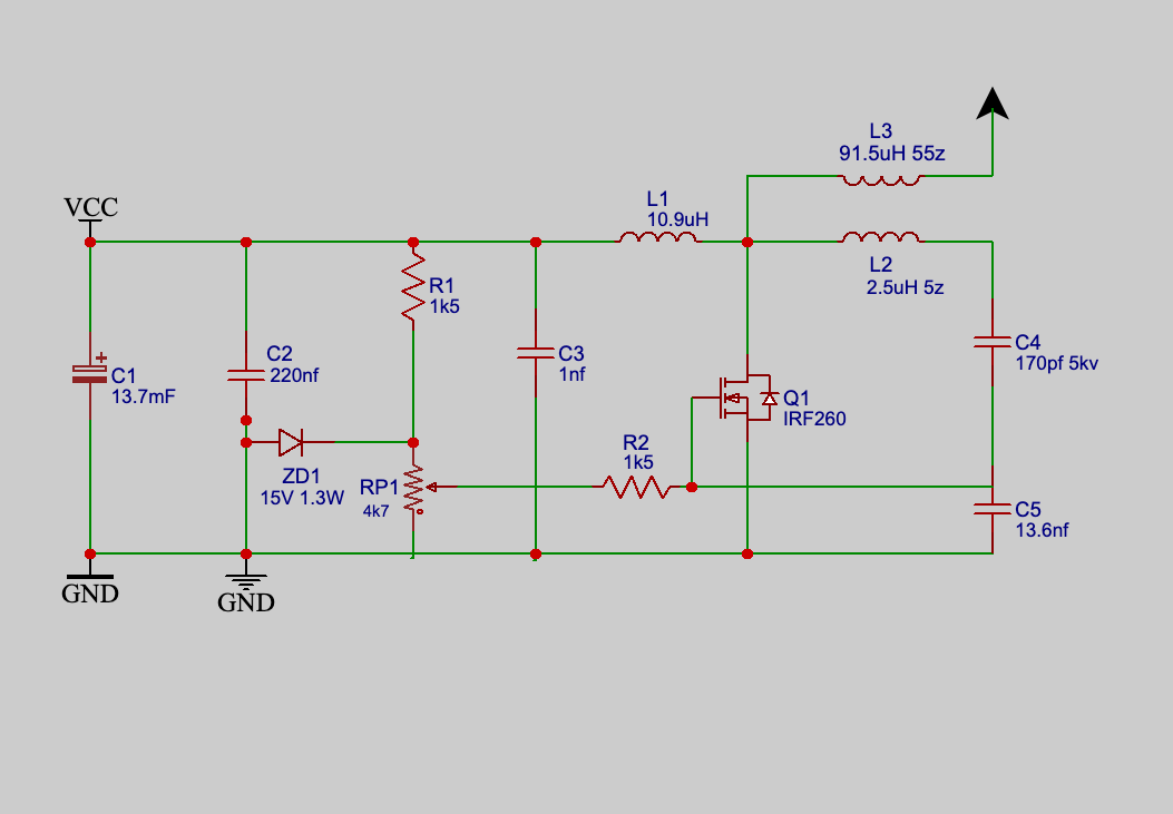

What about in a circuit like this. According to conventional current flow I follow VCC across the top connectors at what point does the current (decide) to start filling C2? Or C3? Or just making a big loop and fill C4 and 5? Or does it go through R1 how do I find which is first when in an oscillator circuit such as this it is important to know.
Voltage is imposed across C1 reservoir capacitor , C2 & C3 are DE-coupling caps, all with power applied at power on.
, R1 is just a voltage divider for RP1, the inductors and capacitors C4,C5 etc appear to be part of the oscillator circuit and will oscillate at the resonant frequency of the oscillator.

I think I follow what your saying, but how would this even induce a current through L2? (I know I’m getting a little off topic, but I don’t want to make a new thread.) As soon as the drain and source are closed L1 gets all the current.
You need to explore the world of tuned circuits, filters and oscillators! ;)
For the initial DC condition, consider it to flow everywhere at the same time.
Remember that capacitors in series act as a divider when they charge or discharge, like two resistors in series; small cap like a high value and large cap like a low value. Most of the voltage will be across C4 to start with, then C3 will charge to the voltage set by the resistors.
With that circuit, I'd then think about the change in voltage across the transformer windings as the transistor switches on or off, and how that change affects the rest of the circuit.
Alright I think I understand the main idea here. Correct me if I’m wrong. C4 and C5 start charging at power on and once the point between these two capacitors reaches a certain (positive) or (negative) voltage I’m not sure which one. The mosfet switches on because of the specific tuning as a result of the potentiometer and R1. Therefore connecting the secondary to ground and discharging C4 and 5 through the primary. From what I see the mosfet acts like the spark gap of sorts.
In a way. The transformer windings couple the changes in drain current, the varying voltage across L1, to L2 and L3.
Those in turn modulate the gate voltage and provide the circuit output.
This oscillator may be easier to understand. The coil is two windings in phase, or one winding with a tap in the centre whichever way you want to look at it.
Like a centre tapped mains transformer secondary, if one end goes (or is forced) positive compared to the centre, the other end goes negative; and vice versa.
If the transistor starts to turn on and the voltage at its collector changes toward negative, making the right hand end of the coil do the same via C2, the left hand end goes positive and that couples to the base via C1, making the transistor turn on harder.
That accelerates the turn on and the collector going negative, until there is no more change.
At that, the voltage across the coil windings starts to drop - making the base go towards negative and turning the transistor off; which makes the collector go towards positive, with the right hand end of the coil following it & making the left hand end go more negative, again until the voltage limits are reached.
The capacitor across the coil resonates it and sets the working frequency, also giving a smoother waveform rather than just a square wave.
It's a bit like one end of a two transistor "multivibrator", but with the coil (actually a tuned circuit) being used to invert the signal before its fed back to the base, rather than another transistor providing the inversion.
Thank you all for the help. I have done a little research on Hartly oscillators and am beginning to understand as you can probably tell I try to understand the schematic before I dive into the circuit. I'm sure you will see more like this later on!
