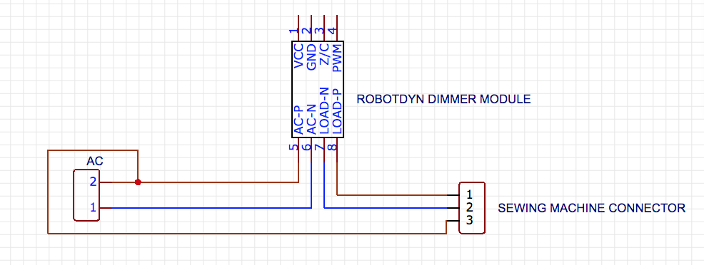

Alright, so is there any risk if I try to wire the module like this if brown is the phase ?
Again, it depends entirely on how the motor is wired. It also doesn't help that there's no circuit for the dimmer module you have - so it's guessing all round.
But assuming the motor is wired directly to the live/phase (inside the unit), and the neutral connection from the motor is connected to the three pin plug for the speed control, and that the output connections on the dimmer are completely isolated from the mains, then it should probably work - but the neutral connections would most like need connecting together.
But it's all guess work, when we've got no details.

On the many Arduino forums, search for AC phase control. Some people call this technique AC PWM control, which is not wholly accurate.
AC phase control is similar to PWM, but the timing period is determined by the AC waveform's zero voltage crossings.
If you employ a Triac with a high dv/dt rating, which vendors like Littlefuse call alternistors, you should have absolutely no problem driving an universal motor.
