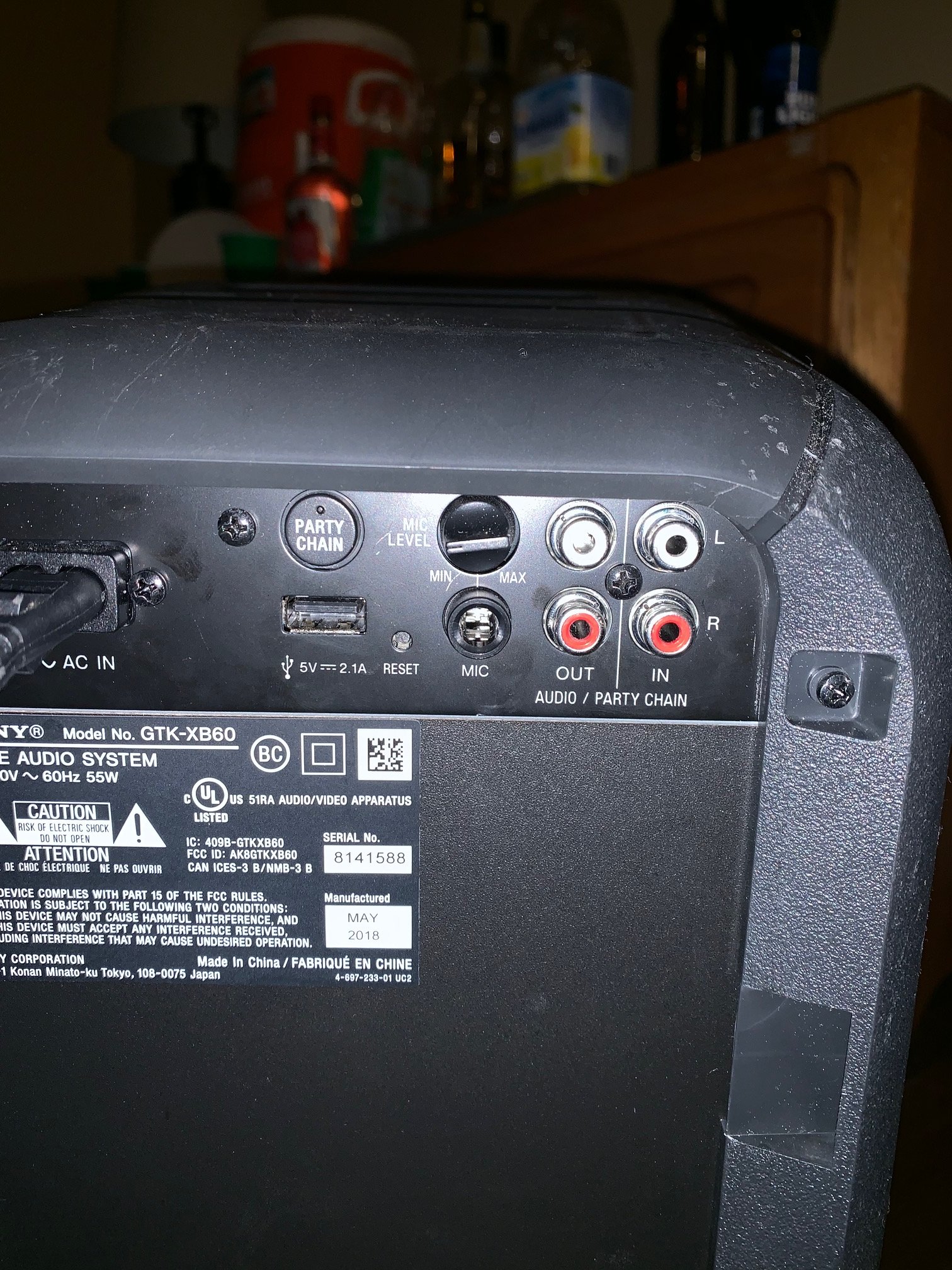

I have a Sony XB60 bluetooth speaker which has left and right audio inputs for RCA plugs. I have two old LG speakers which I am going to use as my left and right speakers. I sautered the RCA plugs into the speaker wires making sure to be consistent with my ground and positive wires. However, when I turn the bluetooth speaker on, there is no sound coming out of the old LG speakers.
I am not sure what I am doing wrong. I have looked at videos of other people successfully doing this and my setup is identical.
Thanks for the help.
Chris

The analog out jacks are intended to connect the XB60 to the analog inputs on another device (tape deck, amplifier, ...). The operate on "line voltage" about 1 volt RMS full scale and cannot drive a 4-ohm or 8-ohm speaker.

Does that mean I need an amplifier? In other words, should the output of the XB60 be plugged into the input of the amplifier and then connect the speakers to the amplifier?

I understand there is RCA outputs, however when I attach left and right speakers into the Sony XB60, I get no sound. These are large speakers and I believe they have a 8 ohm impedence. Does this mean I need an amplifier inbetween the XB60 and the left/right speakers?

Yes. You need an amplifier. You can start with a $5 receiver from Craigslist or from a garage sale down the street. As long as it has "tape" in, or CD in or DVD audio in. Don't use phono in , the audio of phono is amplified slightly differently and output will sound too treble-ish.

but, yes, you need a separate amplifier (an integrated amp, AV receiver or preamp+amplifier component system) to play the audio from the output jacks. Sony "boom-boxes" like the one you have had a lot of power amp and speaker failures (probably because they put more engineering into the fancy "arcade" LEDs that light these boom boxes up than they did the amplifiers)

The bluetooth speaker does have audio out connections. These are the connections I am working with.
Would an amplifier help solve my issue? I would plug the output of the XB60 into the input of the amplifier and then the left and right speakers into the amplifier?

The little speaker does not have much output power (55W AC to its power supply minus its heating) and it has a Bluetooth receiver so of course it has line level outputs to feed an additional amplifier and more speakers.
Those are line level signals that you would need to drive an external audio amp to power the external speakers.

OK, my apologies.
Possibly more than one with a similar name - the Sony specifications for the one I looked up included inputs but not outputs.
In that case, you do need an amplifier to run more speakers, as the other answers have suggested.
