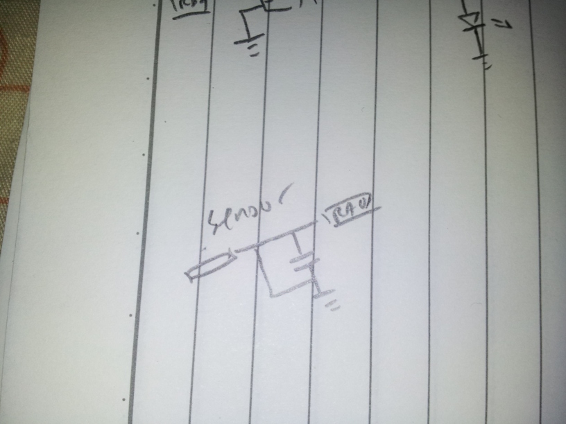

I am required to connect a PT100 2-wire thin film sensor to a PIC16F877A.
I am connecting the sensor to RA0 of the PIC. But it seems like my PIC is not getting any readings. Do I need to connect any other components? Please help me.
The PT100 is a resistive sensor, it will not generate a voltage for the analog input.
You need to make a half or full bridge with the PT100 as one of the elements.
The output from the bridge will require amplifying with a OPA.
Do you follow OK.?

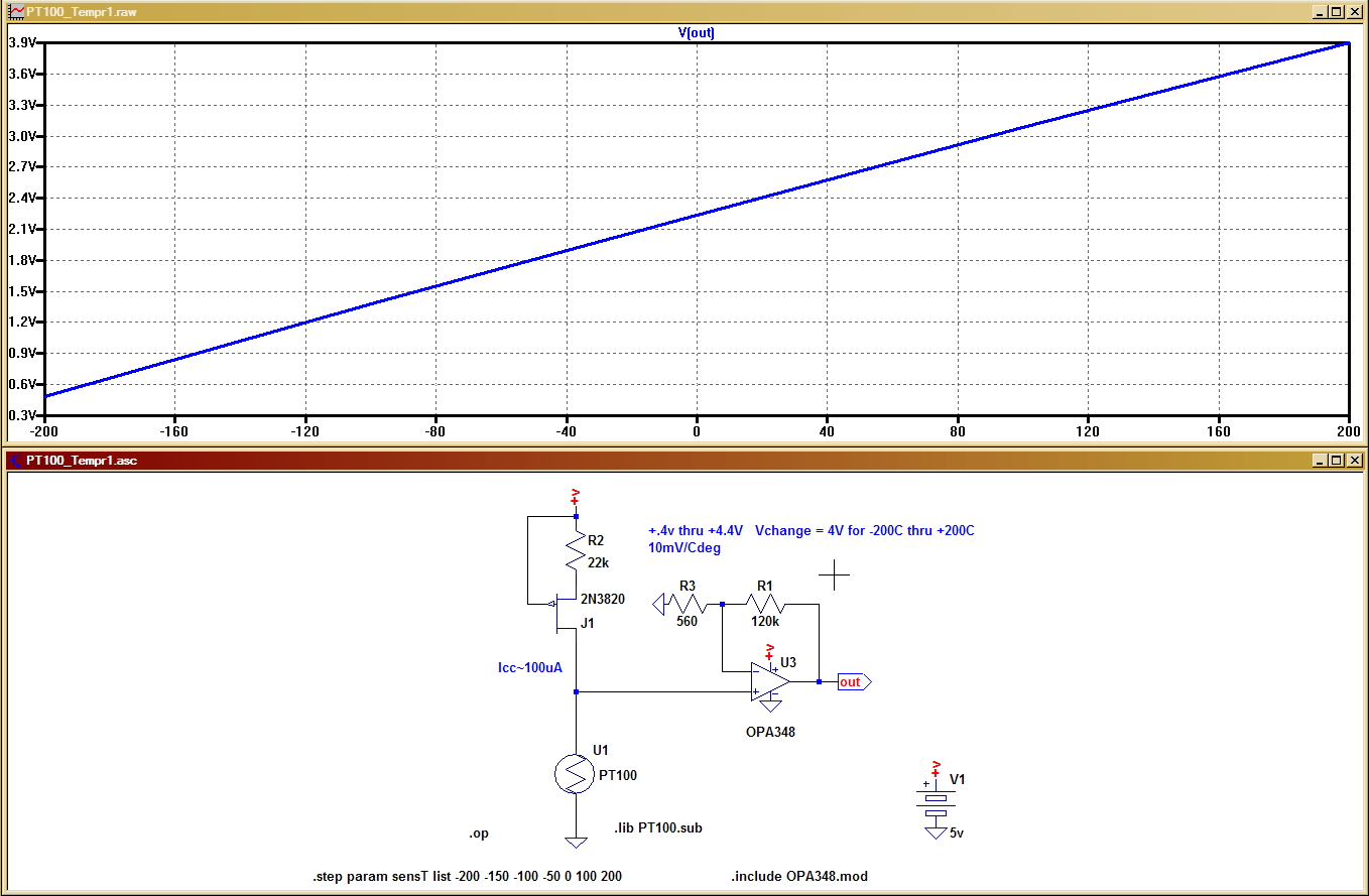

Look at this option.
You did not state the temperature range so used -200C thru +200C
new image.
new image.

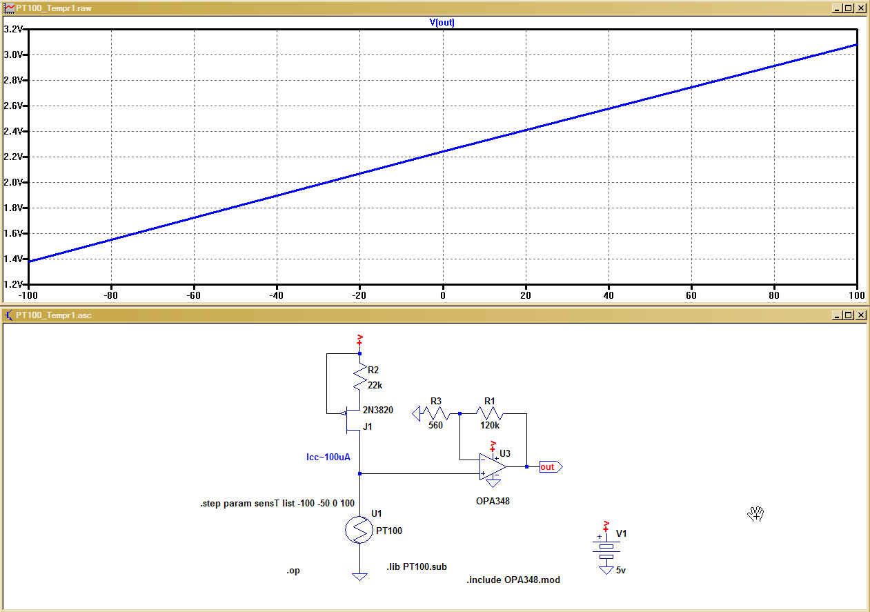

Hi Eric,
Thanks alot. sorry i forget to indicate that the range is from -100 to 100 degrees.
Where do i connect the other end of pt100 and R3?
Hi Eric,
The 'triangle' symbol is 0V,,, R3 and the end of the PT100.
EDIT:
this plot is for -100C thru +100C.
If the Span is not sufficient I would recommend a 2nd OPA, the gain of the first OPA is ~214 already.
EDIT:
