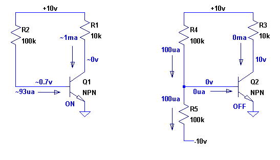

Is there a transitor that is normally open (flowing full current) until a small current flows through the base that will then reduce current at collector/emittor?

No, but you can prebias a transistor and then turn it off by "stealing" the prebias. See the examples below. You can do the same with a PNP by changing the polarities of the two voltages.

:idea: I think I'll call my opposite transitor the SCREECH TRANSITOR after I invent it.
